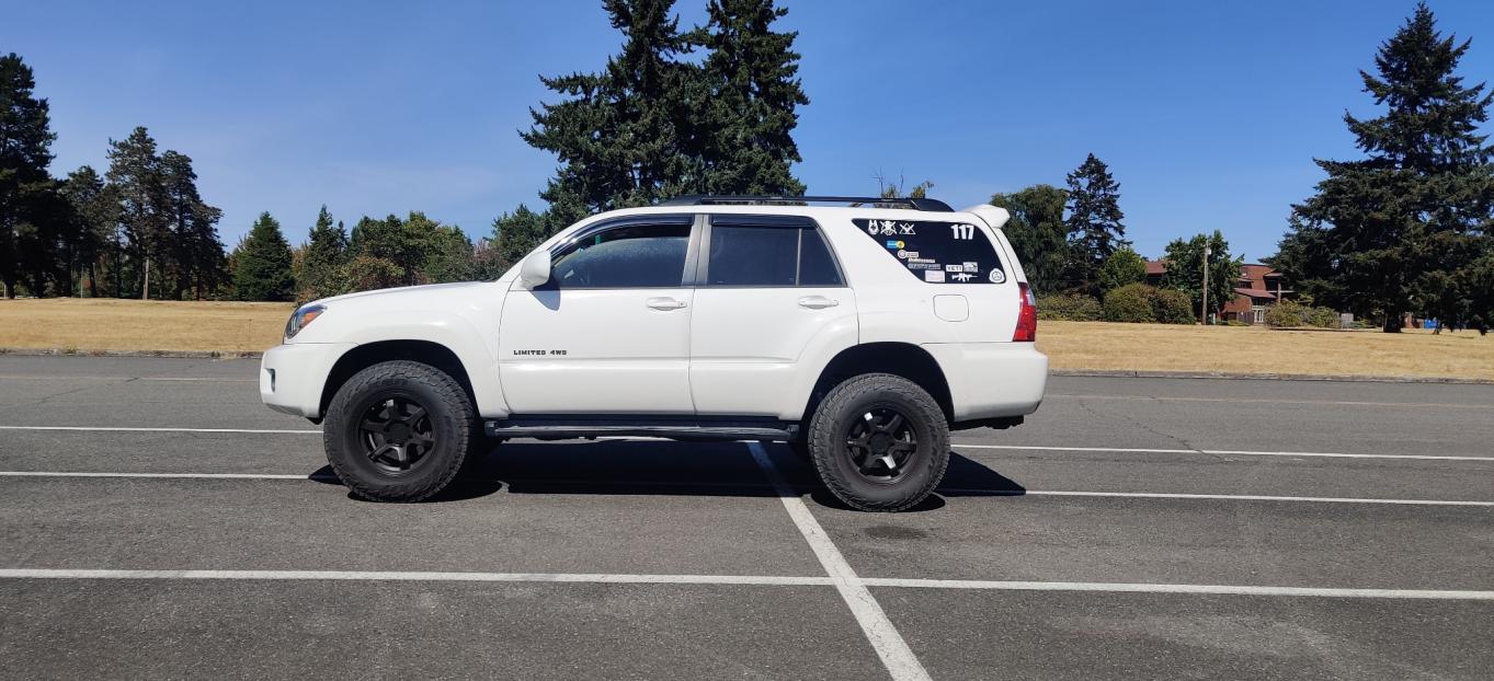

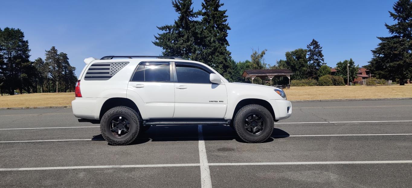

Well, completely forgot I had this thread. No idea if anyone will see this but in any case I did say I would upload pictures. It's been over a year but here are some pictures I snapped today before work.
Parts list located in initial post of this thread.
Went with Dobinson coils for rear lift (C59-325s) and Motegi Trailites 17x8.5" with Falken Wildpeak A/T (285/70).
Initially the lift was good and basically level but after a year it would seem that it has "settled" at this height. The front Bilstein 6112's are set to the max lift setting (which is 3", I think?). I used the front coils that came with the Bilstein kit.
So, as you can see, it is not level and barely looks higher than stock in the front if I'm honest. I rub at full lock on the body mount (tires even catch on the fender and makes a terrible racket) but only under certain situations (uneven surfaces, parking lot driving etc). Otherwise, the ride quality is fantastic and it handles bumpy roads wonderfully.
Next move will be to get the front higher which will probably end up in another thread since I don't think anyone will see this.
