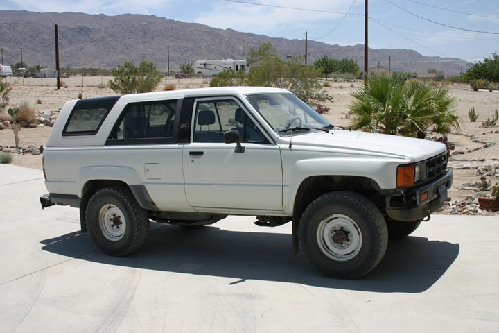

Ok so my 85 runner is giving me more grief. Most of the time when I turn the ignition she starts up fine, but lately I turn the key and the starter just clicks. All the lights come on in the dash, radio and CB have power but no start. Sometimes on the second or third try she will turn over other times I have to wait a few hours before it will start, occasionally it just wont and I have to jump it. It is a new battery and a new starter. The alternator seems to be working fine as the battery holds a good charge. Is there anything else that can be causing this? Unfortunately this is my only vehicle and I need it to get to school and work. Any suggestions? I have tried many things including changing to contacts on the battery.
Thanks for any imput.
