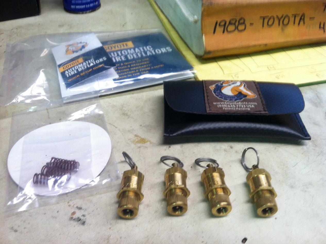

Checked out Staun and Oasis before going with the Coyotes. High quality and work flawlessly.

those coyotes look like they are another good option...i need to check into them some more..is there anything unique about them or are they just good quality deflators??
I suppose the unique thing is the pull ring. Screw em on and nothing happens till u pull the ring. I don't know if it's unique or not since I've only owned these. They are super high quality tho and come with two sets of springs and a nice leather pouch.

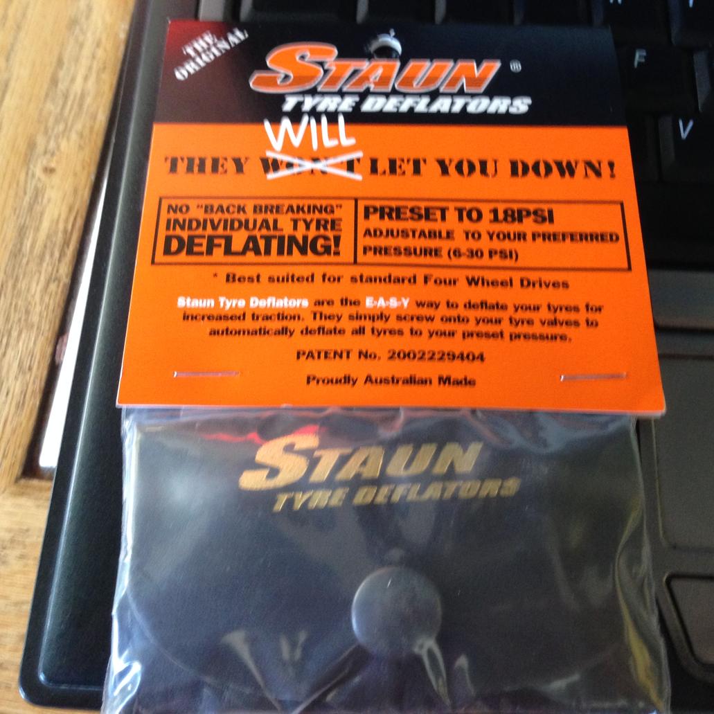

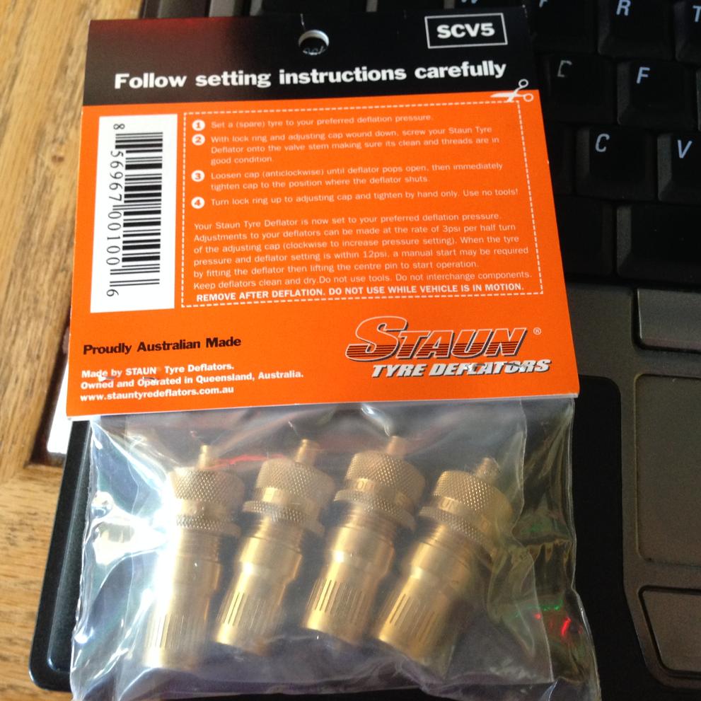

We have great results with the Staun. They will let you down.
Just bought myself another set in preparation for both Overland Expo west and the FJ Summit.

I've used the same set of Stauns for years now. I have them all set to 18 PSI which is a good start if I want to go lower, and yes - they've been letting me down for years without a problem!
