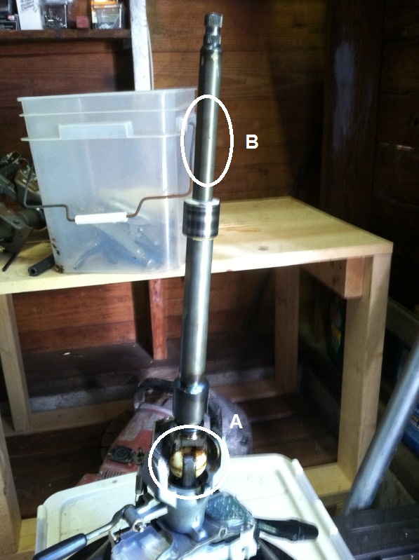

No forward or backwards play whatsoever. My wheel however is loose where it is connected to the main shaft assembly, gonna leave that alone for now.

I took my steering colum apart last week and it looked like the one in the tutorial. Looks like toyota redesigned the steering shaft after 98. Thats good to know.
You mentioned the looseness in the steering wheel where it connects. Thats caused by part A (you may have figured that out, not trying to insult your intelligence). Its an oddly designed little part to me. I mean its functional, but not the best design. And since its plastic I think it just wears out over time which allows slop in the wheel. If I remember correctly, that part is no longer available through Toyota. I would have to double check that though.
And then somewhere around B is where the shaft is seated in a bushing (nelson pointed this bushing out to me last week). I just ordered the bushing from toyota for $5 as mine allows some play in the steering shaft. You should check that out since its a cheap fix.
Also, where the steering shaft meets the connecting shaft (not sure if thats what its called) to the steering rack, the two are connected by basically a condensed version of a u joint. I dont think that part is very prone to wear out, but that doesnt mean it cant. I am suspicous that mine has a very small amount of play. Im guessing you know what part Im talking about as you must have removed its plastic cover down beneath the brake pedal.
