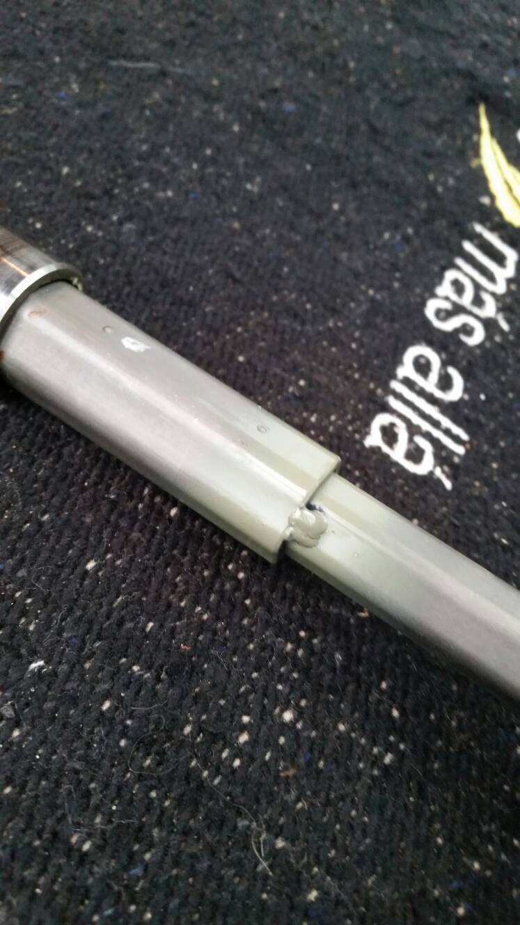

What about the slop also being in the steering shaft inself? The part that telescopes.
I welded mine twice heres the second fix.
