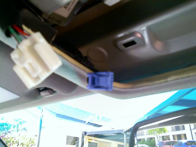

No mic is there, but the wiring is. If you take out your overhead console out and feel around inside, toward the driver's side, you will find a blue harness. All 4Runners (SR5, Limited, whatever) have this (to my knowledge). This is where the factory mic is plugged into.

Looks like this: (from the thread: New 2007 E7009 Navigation Install in 2006 4Runner SE Progress and Findings - Toyota 4Runner Forum - Largest 4Runner Forum )
10427d1151179727-new-2007-e7009-navigation-install-2006-4runner-se-progress-findings-micplug.jpg
EDIT: I thought I corrected this, but 2006+09 4Runner HAVE the blue connector in the headliner, 2003-2005 do NOT.

Looks like this: (from the thread: http://www.toyota-4runner.org/engin...-4runner-se-progress-findings.html#post176568 )
Ah ha! So I wonder, if I got the factory mic, and connected everything through the steering wheel controls, if I could use the factory mic instead of the external mic that comes with my stereo? Guess I'll have to look into it.
Yep. The factory mic is about $50 I think. I have it. Never installed it, but I don't know if I have to. I've since gotten a GX470 overhead console that comes with a mic, but I'm not 100% sure if that (mic) will wire up to my factory NAV. It's been awhile since I've looked at the pinouts.
