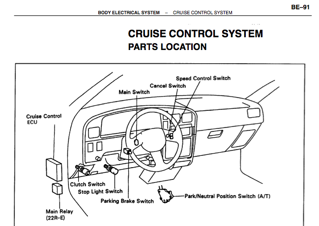

I have a '92 and the steering wheel controls have no identifications on them. I dont know if they are cruise controls, volumes, or what? Can someone give me a diagram or picture of theirs labled?
left side= cruise control on and off
right side little button= cancel cruise control
right side top of long button= accel/resume
right side bottom of long button= decel/set
Do they match this?
