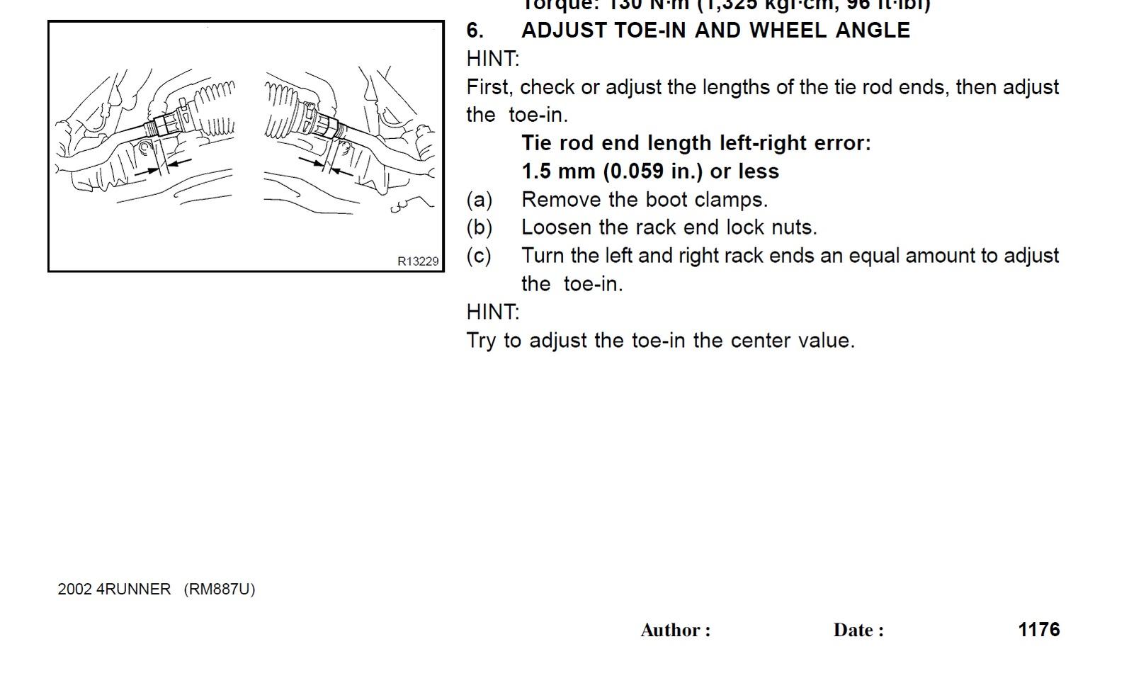

No, No, No... That's not how you adjust the tie-rods! There is no need to separate the tie rod end or touch the boot at all. All you have to do is loosen the lock nut on the threaded portion of the rod, out near the tie rod end. Then turn the tie-rod body (rack end) on the threads to shorten or lengthen it. When you have it where you want, retighten the lock nut and you're done. Takes less than 5 minutes per side. I think you need a 14mm and a 19mm wrench, but I could be mis-remembering that. You may or may not have to loosen the hose clamp on the inner boot so it can spin on the rack end to avoid twisting it. The boot may well be loose enough to spin on its own.
To keep your alignment (toe adjustment) constant, turn each tie-rod body the same amount, only in opposite directions (one shorter, one longer).
It'll take you longer to reset your radio presets after disconnecting the battery to mess with the steering wheel than to do the process I've just described.
Here's a picture and description of how to do it.

That totally makes sense and I should know that...lol.
In that case, I'll just adjust the tie rods. Not sure what I was thinking.

If your steering wheel is off to the left, then when it's straight the vehicle will be turning right. To correct that, you need to lengthen the left rod and shorten the right one, to turn the front wheels back toward the left. It doesn't take much. Try 1/2 turn of the tie rods at a time.
Not a good idea to fix one problem by creating another. The steering wheel is installed correctly unless someone has removed and incorrectly reinstalled it. So, leave it alone. By your description of events, it seems that one tie rod end is adjusted a tad too long while the other is a little short which makes the toe setting okay but the steering wheel off center. So, reduce the length of one tie rod end and increase the other the same amount until the steering wheel is centered. Adjustments should be made by counting the turns you rotate the tie rod ends, not trying to measure length. One half turn or thereabouts per tie rod end is a good initial adjustment. Mark them with a sharpie or something to be able to accurately keep count of turns. If the steering wheel gets further off center, you're going the wrong way with your adjustments.
