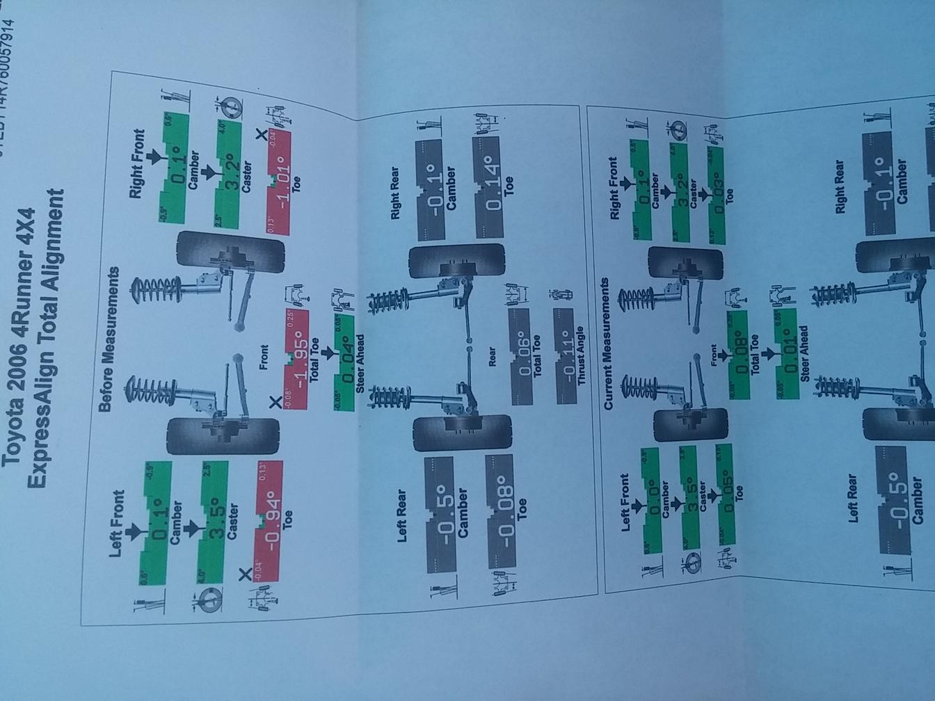

After replacing the following I took it to get an alignment. Alignment specs to me, look great. Shop told me that the steering wheel will not return to center and that there is play in the wheel. I do not feel the play but do on occasion notice it will not return to center after full lock. The alignment shop seems to think it's an issue with the rack. Alignment specs attached.

New rack bled properly? Fluid topped off? Do you think it drives fine? If all that's good just drive it. Alignment actually looks really good.
