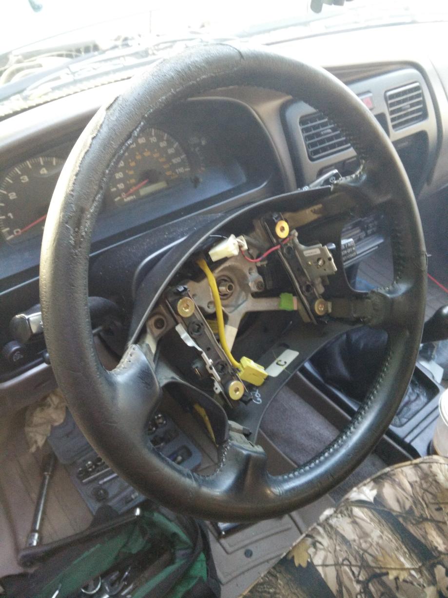

im wondering the same thing. purchased a '99 limited with a chunk missing from the steering wheel. looked up the toyota part and its over $400, screw that!
any tips, write ups or threads on what steering wheels swap would be greatly appreciated!

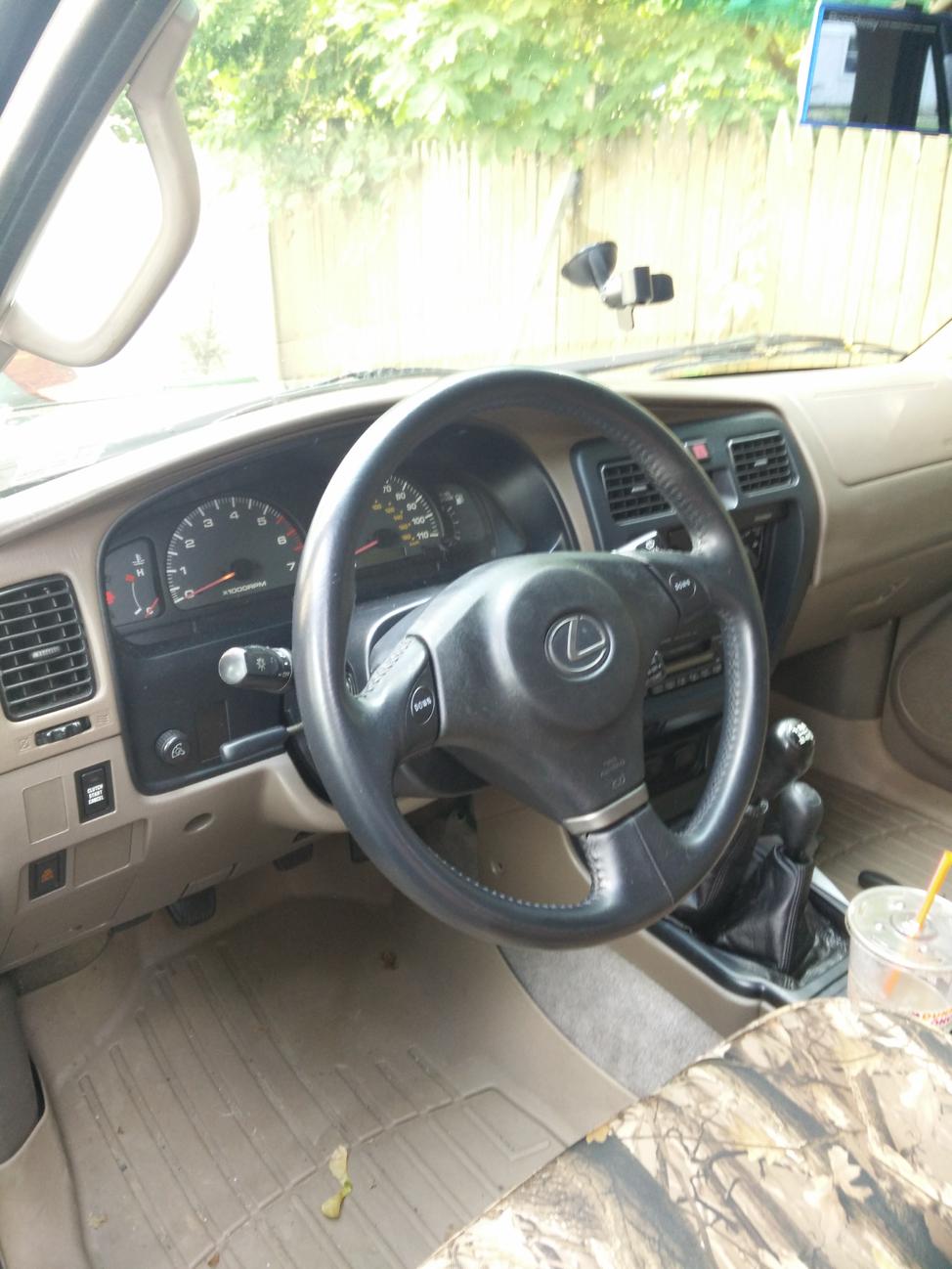

Just did this yesterday very straight forward. Everything plugs right in only thing that was different was the cruise control wire pin out. I dont use cruise control so didn't waste time on re pinning them into correct slots in harness plug.
Finished product looks so much better then original steering wheel with chunk missing. Steering wheel and airbag was from 2000 Lexus is300
