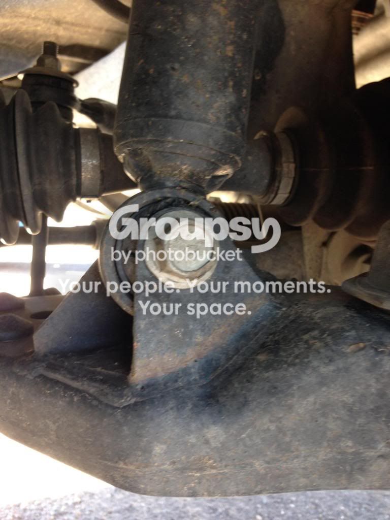

Went to rotate my tires yesterday and found this...
Could the wore out shock bushing cause the shaking im experiencing?
thinking od buying some bilsteins to replace them, any opinions?

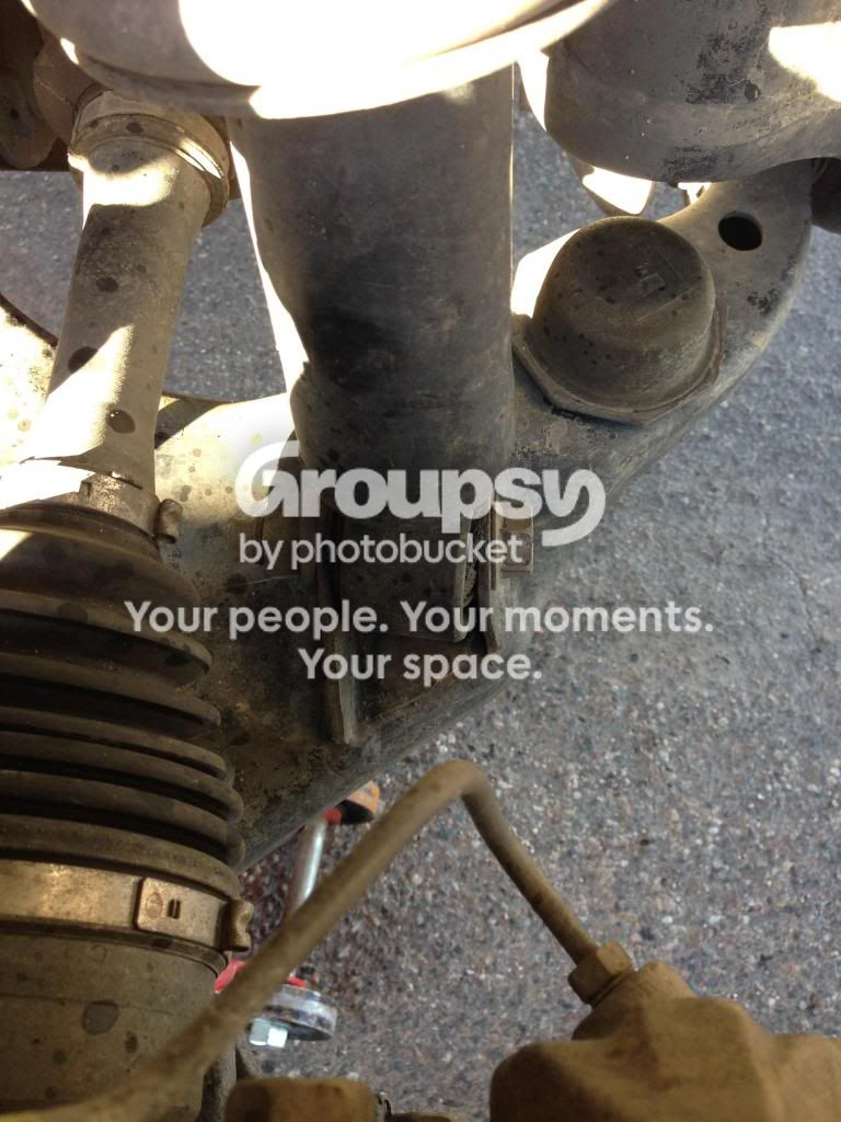

If the shocks are still ok, you can get a replacement bushing and replace that one. You don't even really need a press, you could do it with sockets and a hammer.
I got replacements for my ironman's for $5 each after mine both blew.
BTW, when you reinstall them, don't give the bolt final torque until you have lowered it off the jack. Leave the bolt loose til you drop it, then torque it, that way you don't have pre-load in the bushing. Pre-load causes highly premature bushing failure.
Okay cool, do you think that could cause some shaking?
I'm gonna guess no... the shocks shouldn't have an effect on your steering wheel, but the rotten busing there could easily mean more of your bushings are rotten.
