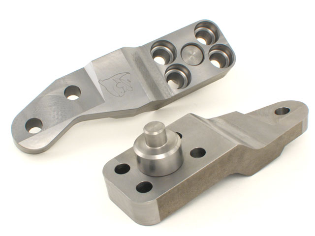

The Trailgear steering arms appear to be designed to install sloping up, to help clear the leaf springs. I haven't handled a set, but it looks like you could maybe install them flipped, so that they slope down the same way the stock steering arms do and run low steer that way. If you did that, I think you'd want a drop pitman arm instead of the flat one, or risk having a pretty undesireable draglink angle. I haven't gotten to that point in my build though, so I could be wrong.

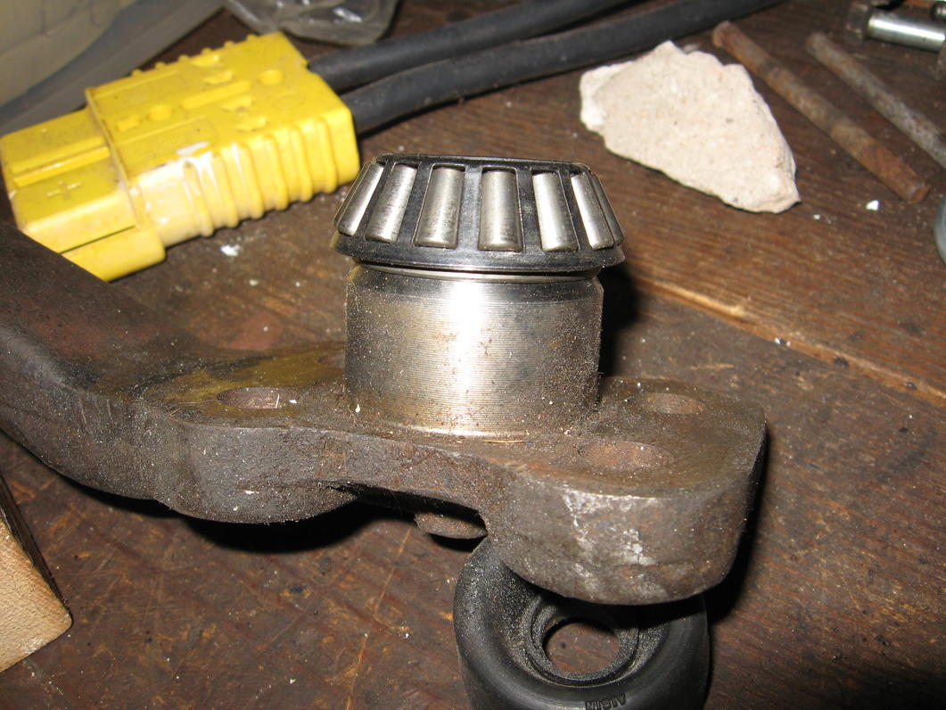

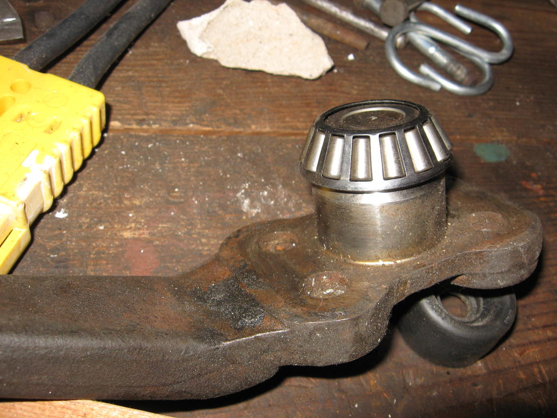

You can't flip a steering arm over and use it upside down.
What would hold the trunion bearing in place ??

Here's a stock arm and bearing from one of my spare axles.
Thank you KV and 4wd1. Once again you've provided me with a quick and expert reply. Again, thank u gentlemen. So I guess I'll be replacing the stock parts. Is there an upgrade over the stock parts like Moog or ? Those Marlin arms sure are sweet tho...
