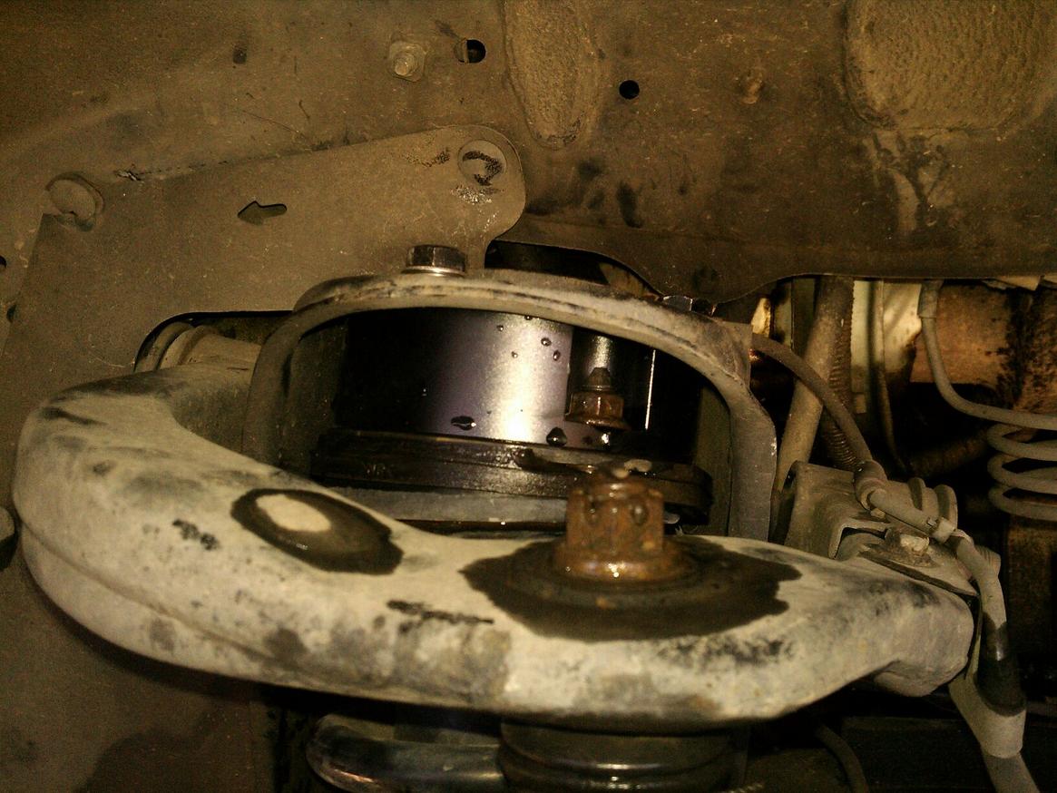

Ok just put on the 3" lift top spacer lift took about 4 hours surprisingly it was way easier then i thought. The part that gave us so much trouble was the passanger side shock them things are a pita to get off when there origianls. I had the same problem with i did my 2wd. So any way it looks great its a kit off ebay for 180 shipped but it dose the job now i need some tires for this any ideas?

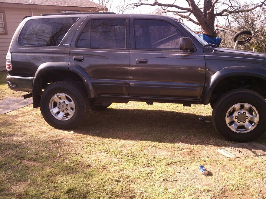

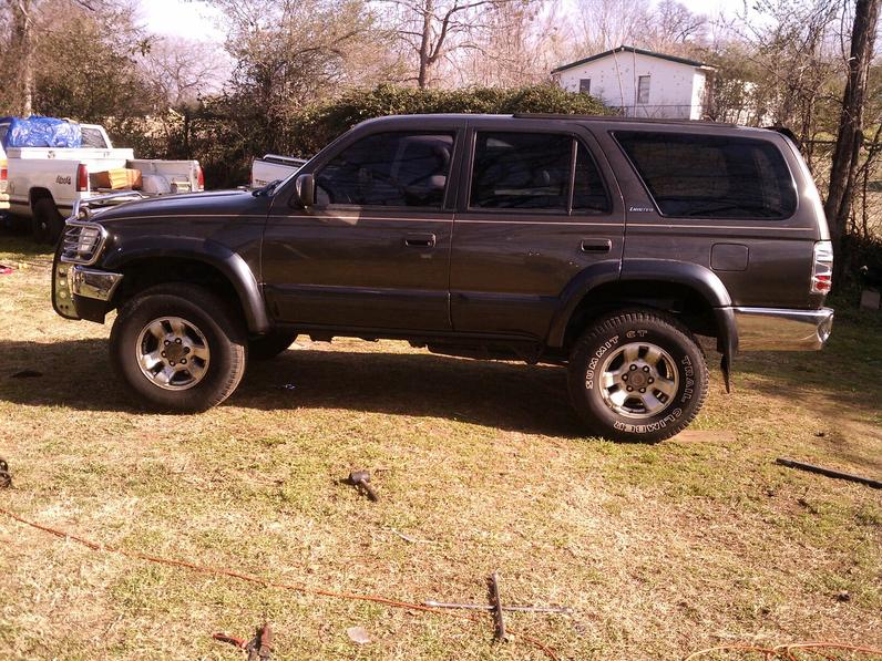

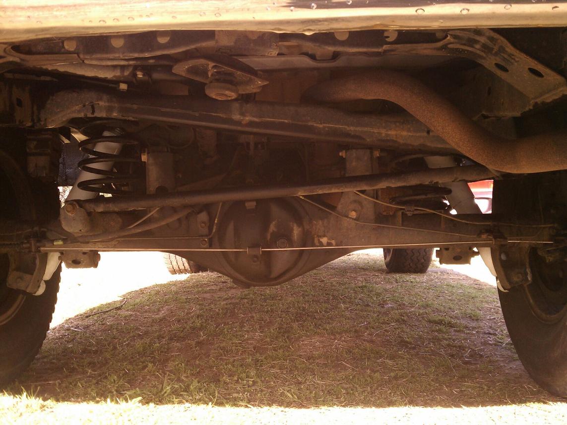

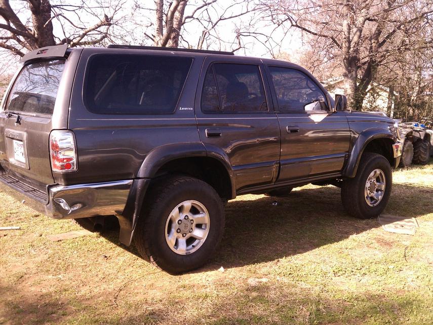

and now heres the pics of the lift installed
The no name spacer
lift with new shocks

well im thinking of going ahead and doing a 2" body lift as well and run some 35" tires I just dont know how bad 35's bog down the 3.4 v6 w/o 5.29 gears. I know i run 33's on my 4cly 22re pu 4.10 gears and i was able to poop and get all around town but it would'nt do over 70 on the hwy. I plan to just use this 4runner on road most times i got a 87 that i can use for a off road toy! so i would'nt be flexing much with it so i shouldnt have to worry about rubbing issues. I read others haveing 3" SL and 2" B and running 35's
Looks good!! I still need bigger tires for mine too! Im running 265/75/16's now, basically a 32" tire. Not near big enough. I will be getting some 285/75/16's soon. Looking good!
