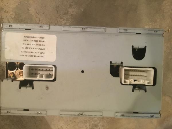

Here's a pic of the back of the factory radio back, note it's upside down in the pic, the two antenna connections are shown right next to each other.
[IMG]https://www.toyota-4runner.org/attachments/3rd-gen-t4rs/196345d1458470019-stereo-help-20160319_141339-jpg
That pic came from this thread, here: Stereo help!!!
Here's another pic from a member's album here

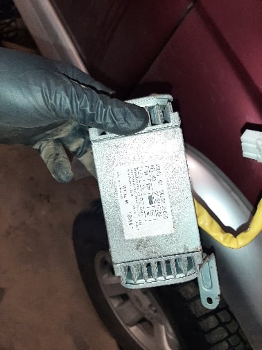

Here is what a 1997 factory amplifier looks like. Two connectors in the bottom and one connector going to the factory radio
Sent from my SM-A505U using Tapatalk
Thank you. I really wish I could post pictures because it would make everything so much easier. I'm just trying to use the factory radio, not aftermarket. I also only see one antenna connector and my radio only has one "port". Do you recall how many plugs are used on the back of your factory stereo? I also do see a little box underneath the radio but I'm not sure what it is, I'm assuming that's the amp.
Yes, that's the amp. Two plugs from that should go to the dash harness. One plug from the amp should go to the head unit. The other white plug (if equipped) is not used.

Just an update in case anyone reads this later. I'm an idiot, and the gray harness was not supposed to ve connected to the radio at all, and it's also what was blowing the fuses. The previous owner lied when she said nobody had taken the radio out since somebody obviously plugged in the wrong connector.
Also, the little "box" that I thought was the amp is clearly labeled "cruise control" and it was soo dirty in there that I couldn't see it. So, radio seems to be working fine now.
