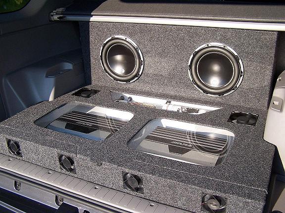

Not bad for doing it under my car port with only a jig say and a cheap router. I installed an Alpine IVA-W200 in the dash but couldn't stand the way it looked so I sent it back. I simply installed some line level converters and kept the factory deck, the sound is amazing, those little 10's put out some serious bass.

Wow dude, that looks pretty damn kewl. Are those PC fans feeding air to the AMPs? What material is the cover for the enclosure?

Thanks, the 2 fans on top are blowing air in and the 4 little ones are blowing the hot air out. I haven't jammed it too hard yet to see how well they cool the amps but I don't forcast any problems. The carpet I used is just regular trunk liner carpet. I also installed some neon tubes in the amp rack, can't seem to get a night pic of it though but it looks pretty cool. Appreciate the response.
