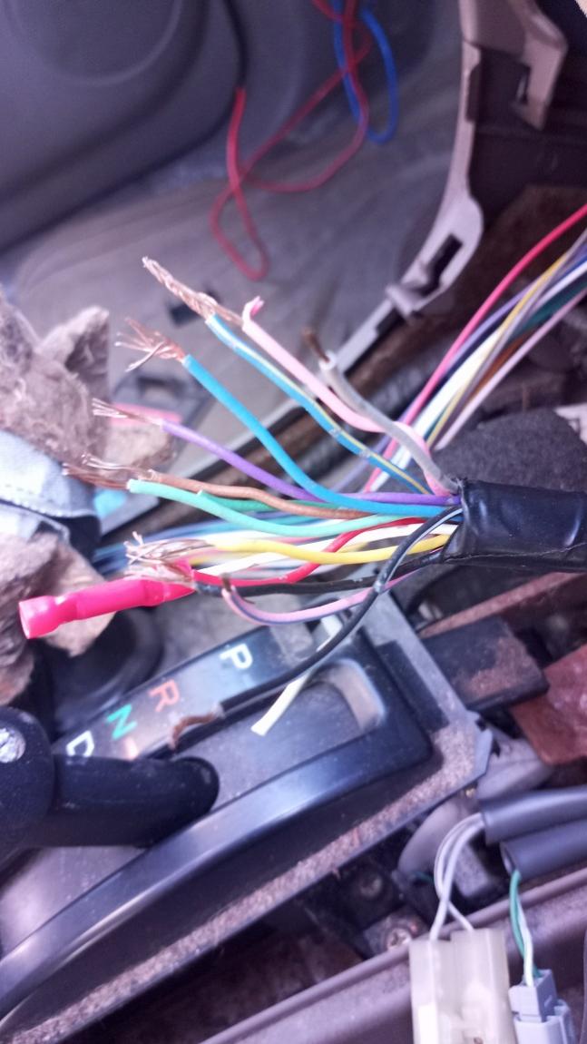

All im trying to do is reconnect this factory plug set
The problem is, every single wiring diagram I've seen doesnt match. For instance, the wiring diagram above features a red and black wire. Mine does not. I don't know what to do about the "power antenna" wires......I'm just totally lost here. Can someone PLEASE help me out here?
This is the wire color scheme my truck has, which of course plugged into the factory amp which is removed.

I'd skip the wiring diagrams.
See it for yourself and you'll know the truth.
So you are trying to re-use existing speaker wiring and power/ground, right?
If so, I would pull each speaker and see what color wires go to each, then connect those to the new amp. So here I am saying skip the connector, cut the correct two colors one speaker at a time and wire into amp.
Then with ignition in On position, I would use a voltmeter to figure out which wire is the hot and ground unless you want to wire those new from battery. If you go that route, use a fuse right at the battery on the hot, safety first.
The only wire left to connect now is the Signal wire, this one receives positive 12v when ignition is on only and signals to the amp to turn on, when you have ignition on and head unit turned on.
You will understand your radio wiring much better this way and can impress your friends.
That's it. Questions?

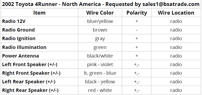

In the 2001 4Runner, the power wire is gray, the constant power wire is blue/yellow, the ground wire is brown, the remote amp turn on wire (added by me between the head unit and the amp) is blue, the illumination wire is violet and the dimmer wire is white/black. I found the color guide at my.prostreetonline.com.
In my car stereo, the amp is powered directly from the battery and grounded to the chassis.
I cut the connectors off the factory wiring harnesses and connected the wires I needed to my head unit individually. I only used four wires in my whole system that are “Toyota” wires.

OKAY, THIS IS THE INFORMATION I HAVE BEEN LOOKING FOR. YOU TWO ARE THE HEROES OF THE DAY. I'll be sure to be a good one and check back in with a field report.

In a nutshell, bought the truck used, can't find any comparable model year 4runners in the local junk yard with said plugs, the metra aftermarket replacement OEM plugs are not toyota color coded, so I had to translate the colors.
Here is the color coding for 3rd gen audio. This is for the standard audio 4runners, not the factory amplified ones.
