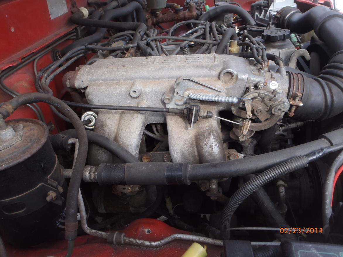

my '87 had the same issue. didn't always hang, but it would on occasion, resulting in high idle.
i added a stiffer spring. not replaced, added. so, there is now an extra spring to pull the throttle back to the stop once the pedal is released. it has been installed since late winter, and seems to have solved the intermittent high idle.

Throttle cable too tight? When I adjusted mine I accidentally made it too tight so it wouldn't close all the way. If not I say the spring is worn out.

Yeah I will probably go with the additional spring option. I had a heavier spring on there before my mechanic "fixed" the truck 3 days ago. I was trying to not have to go that route and have the truck fixed the right way. Looks like I wasted $300 bucks on having him replace the throttle body. I won't be going back to this mechanic. It's about the 5th Time I've come in for the same issue and he gives the truck back to me saying that it is fixed and then the next day the issue starts happenening again. It makes me worried because this is the same guy that rebuilt my entire engine. Thanks everyone for their ideas on this one. If anyone knows how I could clean or lube the throttle the right way please let me know!
washer behind the spring pack,its sticking.worn out.

just shimm it from the back ,mine doing it too.thin washer on it ,after you pull off spring,throttle cable.i gotta do mine
