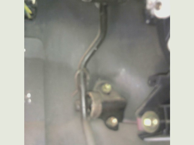

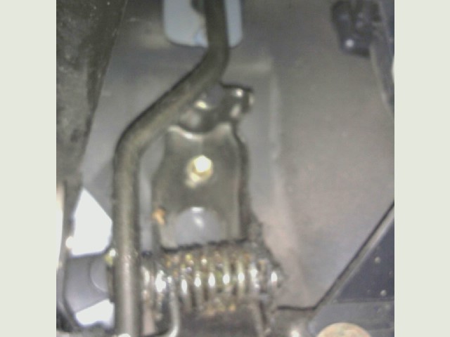

The problem isn't the cable or the throttle body, it's the spring in the pedal. I have a 1995 Runner that has a really sticky/stiff pedal and a 1998 Runner with a buttery smooth pedal. I took pictures of the assembly of both. The picture with the small spring is from the 98 pedal and the massive spring is from the 95. So the problem is because of the huge spring. Does anyone know if I can buy the part from the 98 and put it on my 95?

I have tried lubing the cable also on my 1997 with no luck. I drove my neighbors 2000 and the gas pedal is night and day difference. Has anyone tried installing a smaller style spring on their throttle? Where is the best place to buy one if it works, also, did it fit right up?
