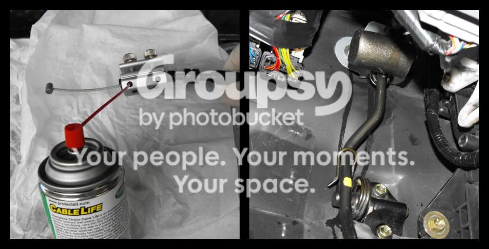

The gas pedal on my 97 was always stiff. Came that way from the factory from what I've noticed. Though I think they changed it up a lil bit because on my buds 02 t4r his gas pedal is nowhere near as stiff.
I guess you guys should just chalk it up as a "Yota thing". Though I'll try the lube deal and see if that helps it out some.
See lube seeping out at the gas pedal end.

Do you happen to have a picture of the gas pedal where the cable attaches to it, right above that weight/dampener? Mine has some slack there, giving it some "dead course" and I would like to compare.
I actually used WD-40 instead of silicon spray or grease, because thats all I had laying around and still did the trick.

The problem isn't the cable or the throttle body, it's the spring in the pedal. I have a 1995 Runner that has a really sticky/stiff pedal and a 1998 Runner with a buttery smooth pedal. I took pictures of the assembly of both. The picture with the small spring is from the 98 pedal and the massive spring is from the 95. So the problem is because of the huge spring. Does anyone know if I can buy the part from the 98 and put it on my 95?

Pb blaster isn't bad but both wd-40 and PB blaster are penetrating oils, use a white lithium grease version. I used the wd-40 white lithium grease on my 1995 cable that isn't really for this car but is the only replacement I could find. (Let me know if you need the part number, you will need to drill the firewall if going to use it.) I 3D modeled a replacement to the rubber bushing that seems to always blow up or split (I can send the model files too if you want to print it and the specs and other equipment needed). If your throttle pedal is stiff though this isn't a hard fix and seems to be common on these cars. Simply unhook throttle cable from the throttle body and get it as straight as possible (doesn't need to be taken off of the pedal or firewall) if u can angle it to let gravity feed the lube then it's a little easier. Get some white lithium grease or another kind of lubricant, pull cable too you, spray cable and inside the sleeve. Next work the cable back and forth in the sleeve and repeat until you feel comfortable. Must I add this doesn't immediately fix it you will need to drive it and wait, but the more you work it and more lube you put the faster and better it should work.

I'd say just buy a new cable and be done with it. My cable was getting horrendous on my 2000 even though it had felt stiff the whole time I've had it since 2018. About 4 or 5 months ago I bought a new cable from McGeorge, and it should have been one of the first things I did 5 years ago. It drives like a completely different vehicle with the new cable. Personally, I wouldn't recommend lubing a worn out cable. Just replace and you'll be glad you did every second you drive it.
This is happening to me on my 98 limited....
The cable care kit with a bit of effort can work most cases, a new cable is a instant fix.
Pick a weekend couple days for job. Disconnect cable from TB and all clips to firewall hang it from hood, chit flows down.
Spray Lube let soak work pedal rinse and repeat till cable moves freely or not. [MENTION=756374]flyswatter_studio[/MENTION] said it first.
