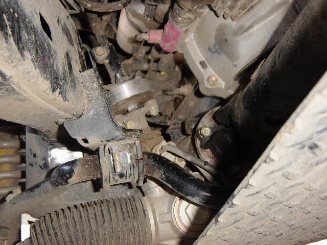

Stole this photo from Roger Brown... If you look at the block of Aluminum in the rag joint, follow the steering shaft up and you'll see a single bolt offset to the shaft looking back at you. That's the guy you want to loosen. Then spray the splined shaft liberally with penetrating oil, turn the wheel a few times and tighten back down. Hope that helps...

That worked. Steering actually moves by itself out of turns.

Thanks for the help Socco. I should have been a bit clearer about the clamp and the spline shaft. The shop hadn't touched it, as it was obviously tight and seized. It took some major lube for me to get it free. I loosened it once on Thursday and it felt better, and then I figured since it sat all night with the penetrating oil that I'd give it another shot yesterday, and it felt even better. I was worried about letting out too much, but knowing now that it has about 4 inches, and by looking at it in detail with a light yesterday when I was loosening it, I feel confident it's not going to give out in the middle of a ride.
