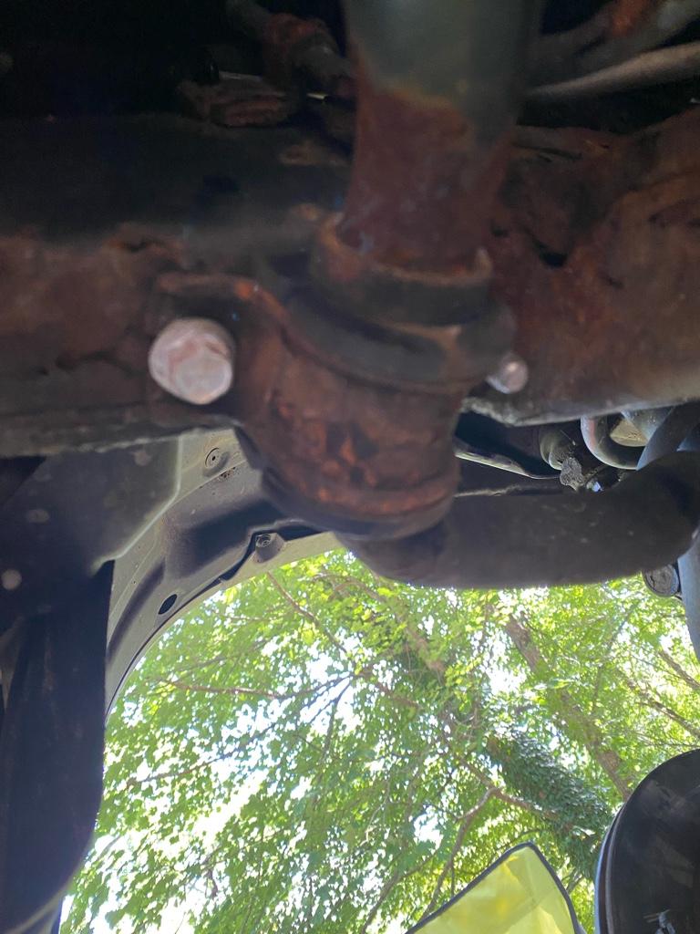

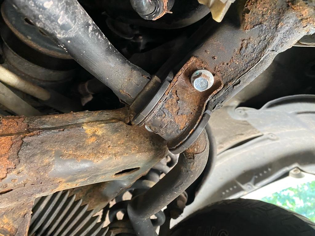

Found some pics of the sway bar I took a while back. I wasn’t paying too much attention at the time, but it’s looking pretty rough. Even seeing some cracks on one side. I guess I need to start looking for a new one. I just ordered some Energy suspension bushings too.
the "cracks" are just the paint coating, not the bar itself. you most likely dont need a new bar, just install the new bushings & see if they fix or improve the clunk & go from there.
That’s good news, although I may just give it some kind of rustoleum paint while I’m at it.
If the bar is actually cracked, it will break at some point very soon. So I wouldn't worry about replacing it, it'll let you know.
The clunk is the steel bar being able to move back and forth. Normally, it's held rigidly and only able to rotate as the suspension moves up and down... doing it's job of being a linear spring. Once some play is available in the bushings it bangs around in there.
There's a huge amount of force involved in the sway bar system. I generally kill a set every couple of years. Speaking of which, mine need replaced too.
That’s interesting. I didn’t suspect the sway bar initially because I didn’t think it would generate that loud of a clank. I just ordered new bushings, so I’ll take it off and give it a good check when I put those on. If it still squeaks, I guess the sway bar links are next.
