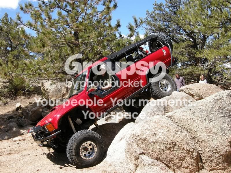

Pop on some fiberglass "Red Chili" style.
RedChili.jpg~original
I want the Chili. So bad do I want the Chili, that truck is probably the sickest 1st gen I've seen. Slacker's fiberglass just isn't in the budget for this build, unfortunately. Not short term, anyway, and I really need to take care of this rust soonish.
