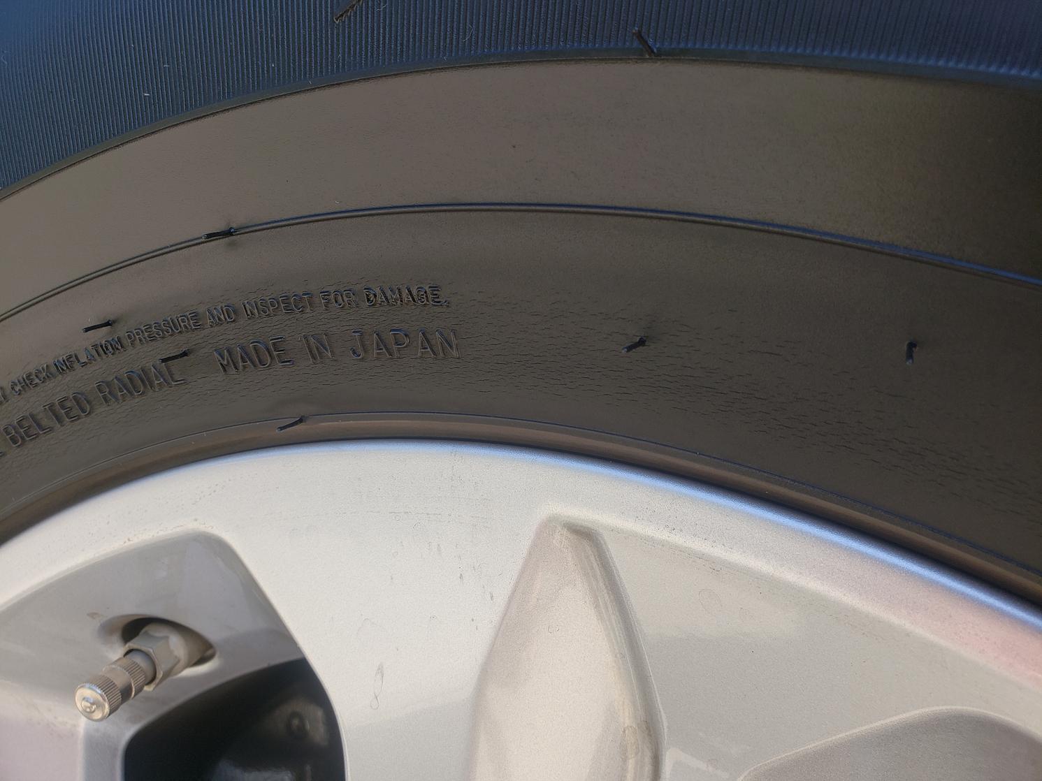

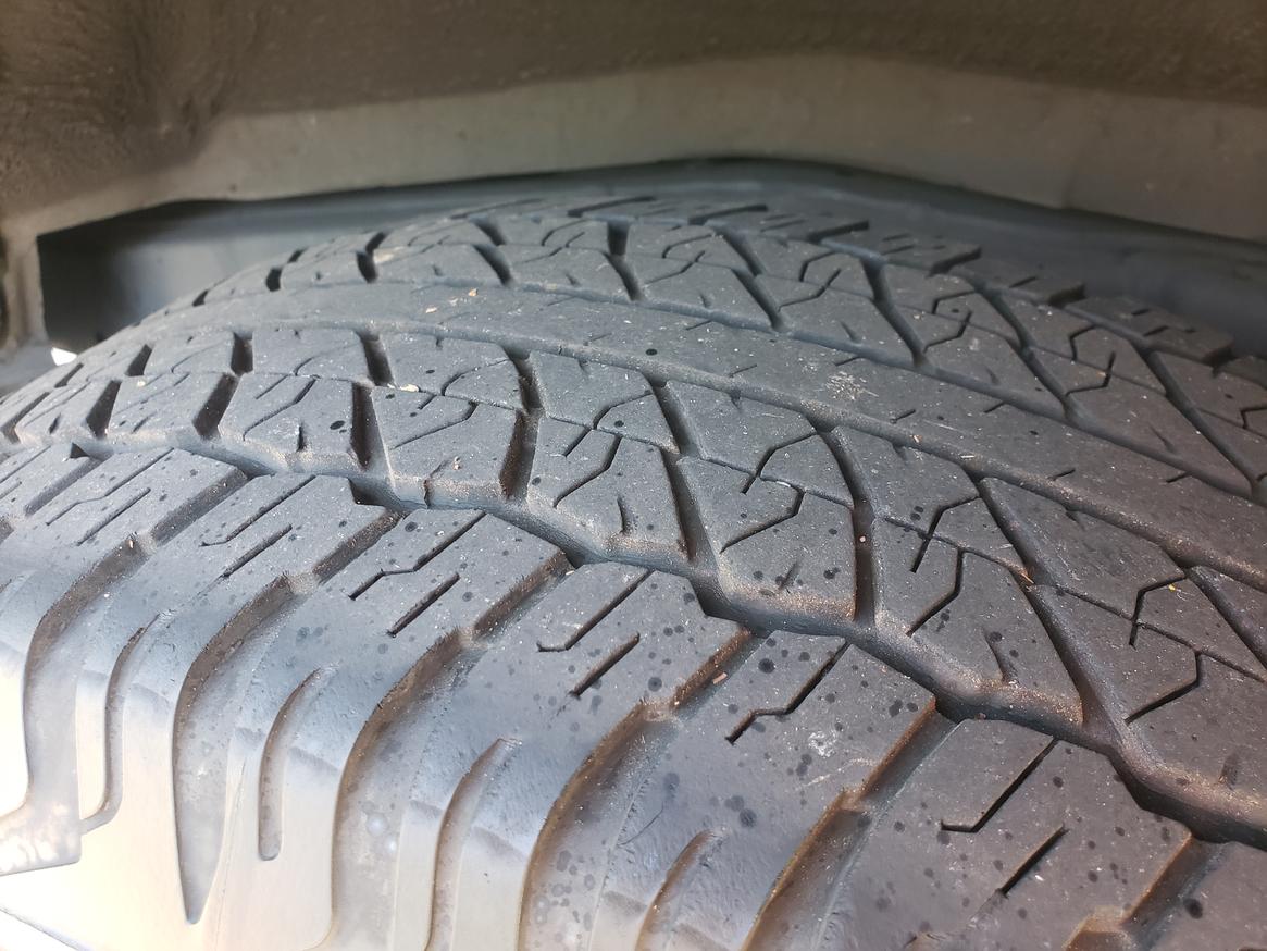

My 4Runner came with the Dunlop Grandtreks instead of the Duelers. They seem to have a few thousand miles left of tread, but the sidewalls have begun to crack. I have attached pictures. This is the same story for all four tires. Kind of disappointing especially because I had no intention of replacing them until they wore out. I know that they're not the best tires, but they do ok for a highway commute.
So what should I do? I don't like to mess around with tires, so cracked sidewalls make me feel uneasy. But the cracking is not too bad yet.

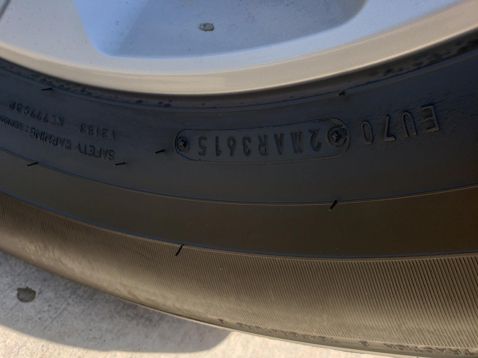

EDIT: Tire manufacture dates are all 3615 so just about 3 years old.

Personally, I would use this as an excuse to upgrade. That said, I ran a pair of Michelins on a commuter car for nearly 90k miles. They were cracked worse than this when I sold the car. I brought it up with the tech who was rotating them for me (every 5k like clockwork), and he didn't think there was anything to worry about. Since he stood to profit by telling me to replace them, I figured it's probably not too bad.

The dry rot/cracking on your tires is not significant, I wouldn't hesitate to change them to the LTX for safety alone.

Your tires are fine but you're over inflating them. Based on your pic the tread does not make contact with pavement along entire width of "contact" area.

He's talking about the lack of siping on in the middle of the tire. That's an indication that you're over inflated as the tread has worn down to a point to where the little squiggles are less visible compared to the tread closer to the sidewall. Also, your tread depth in the center looks to be shorter than that of the tread nearest the sidewall. Using the head a penny or quarter as a gauge, you should be able to tell for sure.
In an opposite situation of that, if you were under inflated, the tread nearest the sidewall would be more worn, while the middle would look new.

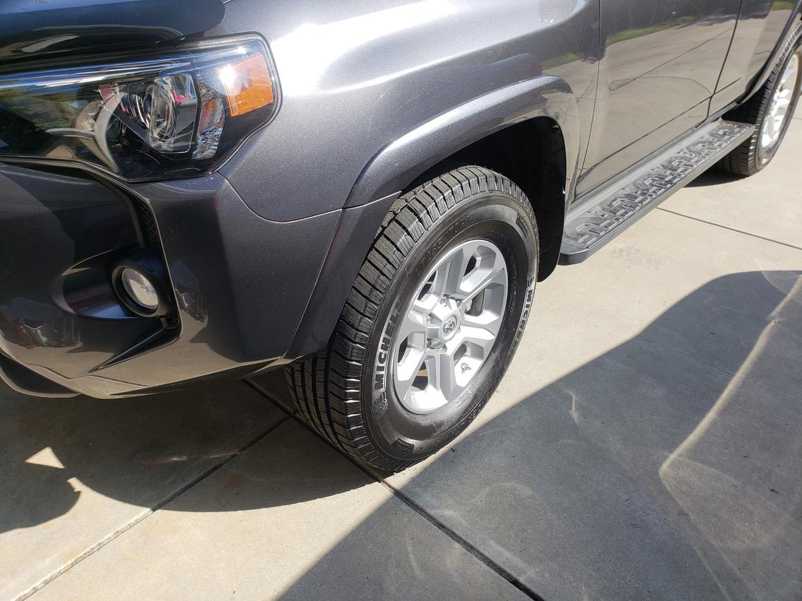

Used it as an excuse to upgrade to the Defender LTX. Went with the E rated version, so far I haven't really noticed a difference in ride quality (not a bad thing). Will post pictures. Made sure that they are at 32psi so I don't have anymore abnormal wear. Thanks everyone for your input, much appreciated.
