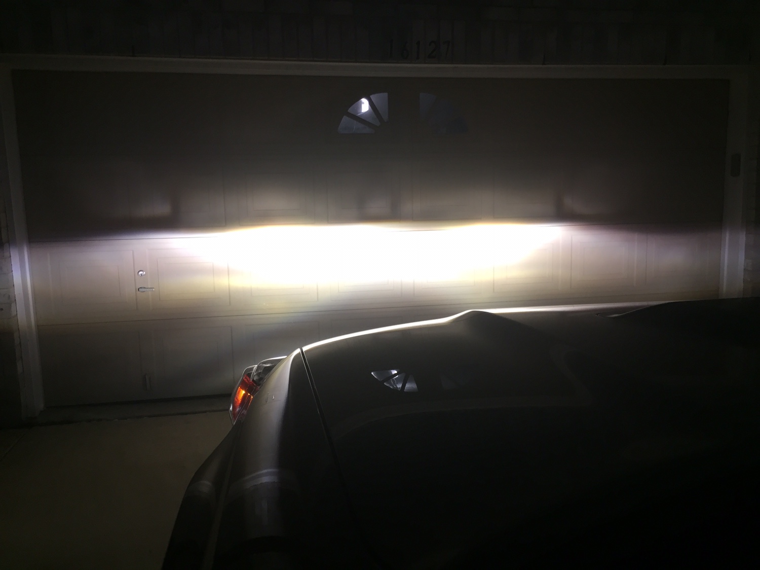

I went the 4300 route. I don't regret it, IMO the stock lights were horrible. I chose not to go with LED just due to past experience. I'm sure there's other opinions as well. To contradict that last statement I did just get my ridged fog lights on Monday. Those are going on once my new bezels come in Thursday. I will say there probably is a slight issue with my projectors and the HID. They are called squirrel spotters and it a small piece of metal in the projector that aims light upwards at a 45 degree angle. This assists lighting up signs at night (hence the name) yea I'm kidding... anyway it doesn't appear to bother on coming traffic though I've read it can be an issue. I'm fine with I guess, still better than stock. My other cars with HIDs have a solid light break line. Here's a shot a 10' away. Sorry I don't have a before. Try taking a picture of yours to compare at 10'
