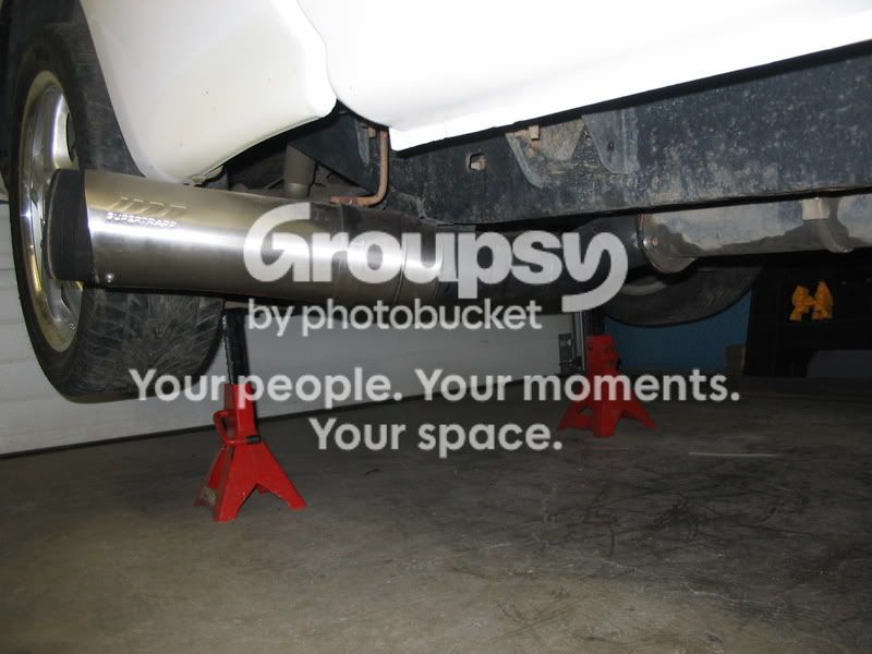

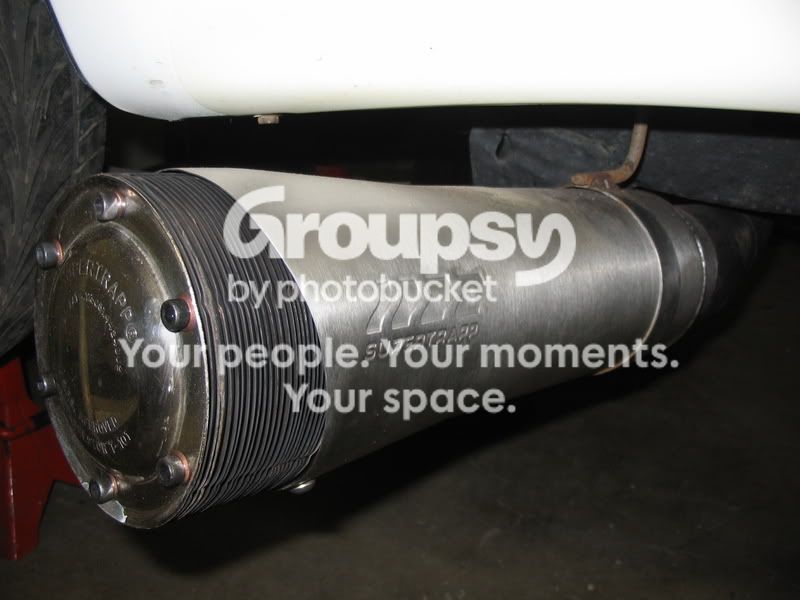

This is a SuperTrapp on my Tacoma
IMG_4437.jpg~original
IMG_4438.jpg~original
I'm goina get rid of my stock muffler, put a small air tank there for a air horn and install a 2 1/2" SuperTrapp in the tail pipe location.
