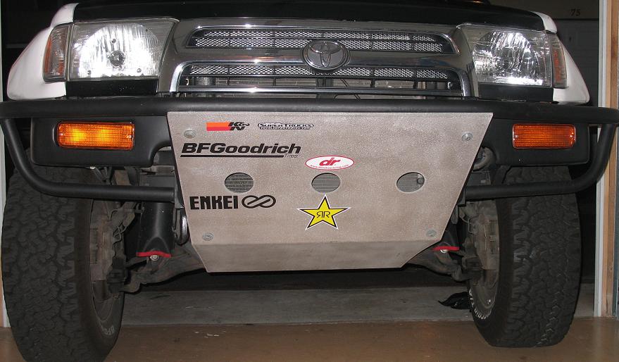

I cruise the SoCal desert, and I always kickup rocks and stuff flying thru washes. So I had to go with a custom skid plate.

Re: Alittle overkill, but will keep a rock away from my oilpan.
Chichi said:
Daiiiing!
That is some serious negative camber you have going there. I would check into having a camber adjustment unless you do not mind uneven wear and shorter tire life..
