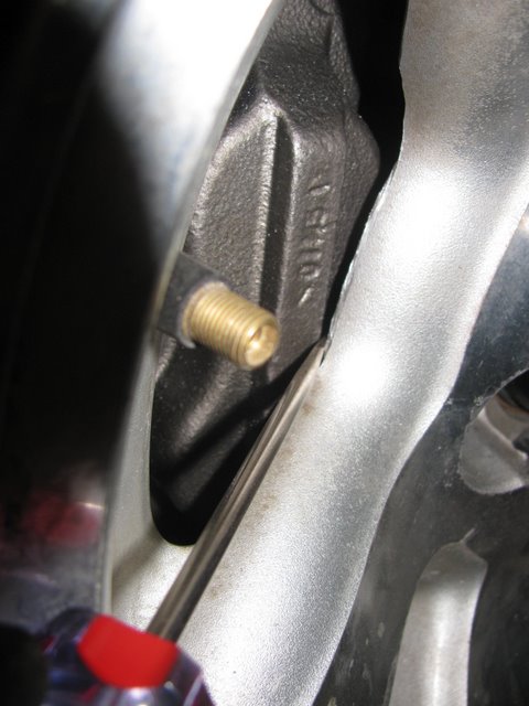

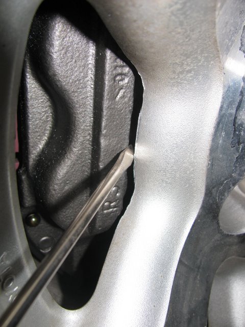

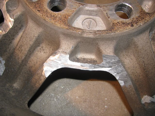

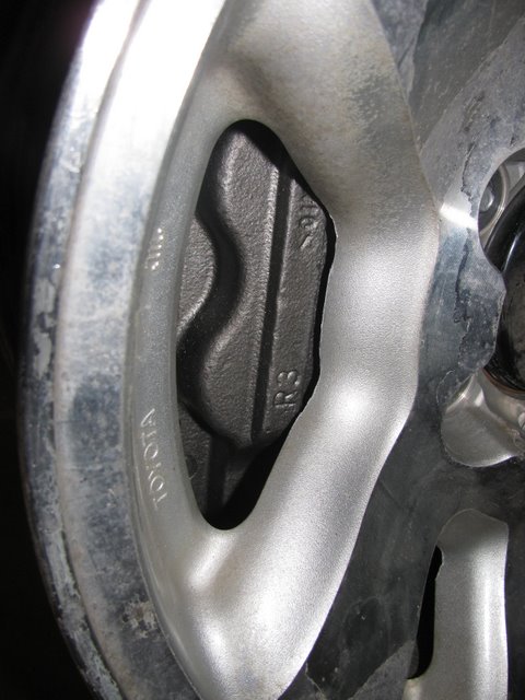

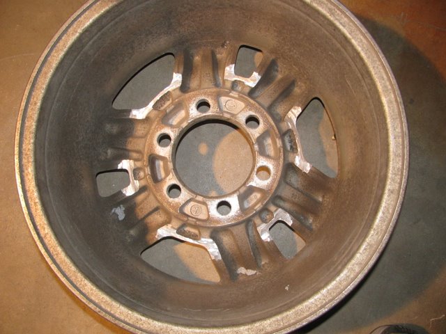

Here are some pictures of a split three spoke ground down to clear the 231 brakes. I'd guess I removed about 3/16's of an inch of aluminum, and that a 1/4 " spacer should allow the wheels to clear if you don't want to grind the wheels. Just a guess.
I'm using this wheel as my spare as the stock spare does not clear the 231mm brakes. Not even close. I have no idea what size spacer would be required for the spare to clear.
Thanks a ton for the pics and explanation. I figured a 6mm or 7mm spacer should work and your pics support that idea. And I assumed the spare wouldn't be anywhere near fitting but if I ever get a flat on the front I'll take a rear wheel to the front and put the spare on the rear since there wouldn't be any fitting issues there :eyebrows:
