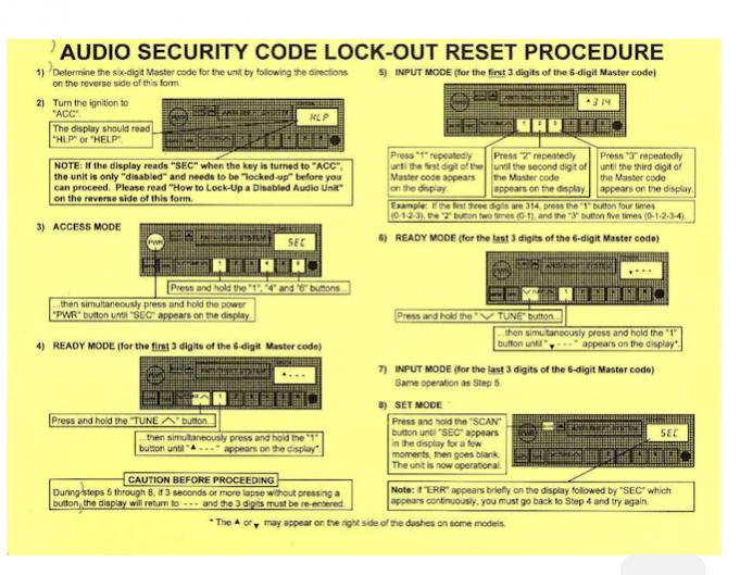

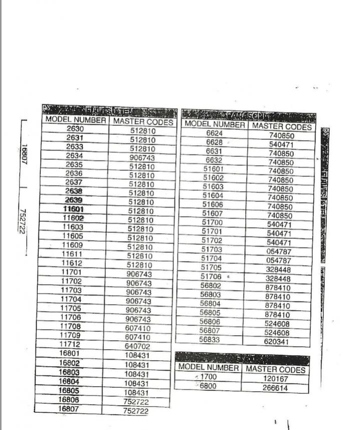

Coming back here to say I figured it out. If anyone is looking for this I hope this helps the next person:
Head to ToyoDIY.com, and type in your vin. then go to electrical>radio> and find your radio model number. mine was 51706 (1997 4 runner sr5 sports) code for it was 328448 but if you need to find other codes check the pdf in this forum How to bypass disabled or locked up radio codes | Toyota Nation Forum from an old manual.
