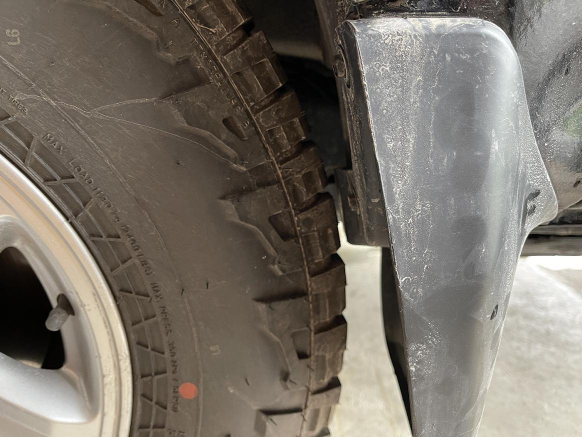

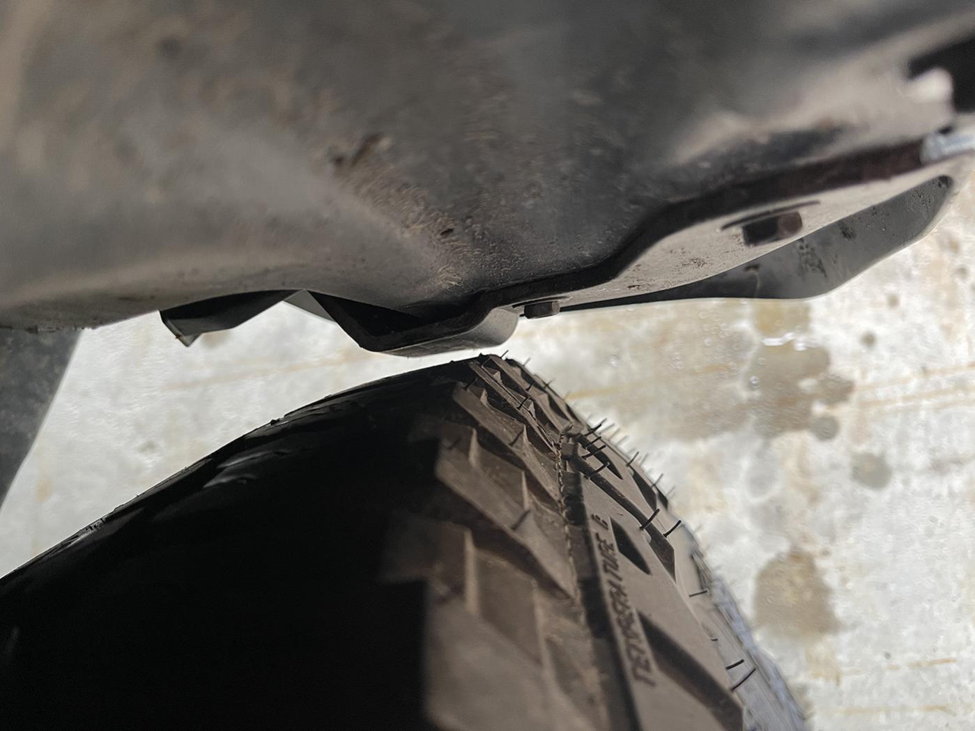

I recently put on some Falken Wildpeak tires in the stock size and had an alignment. After the alignment, I started getting some tire rub on the left side mud flap. I went through the paperwork and realized I never got a print out of the specs so I can't see exactly where everything is at. I've seen countless threads of this happening with larger tires and a lift but don't recall seeing any with stock tires.

Mud flap? Are you referring to the rear tires? If so it's solid axle and does not receive alignment. Maybe they rotated them around and a slightly larger one got swapped in, now causing rubbing?
In any sense, caster angle is what determines how far forward your wheel is, so if by some chance you're referring to the front I'd just go back and ask them to increase it/set it back to where it was
Edit: just realized they're brand new. Could be the size of the tread being increased opposed to what you had previously. I'm assuming you didn't notice rubbing before the alignment when you still have them on, at least

They'd have to really pull the caster down to get the tire back that far. You say stock sized tire - can you confirm the actual numbers on the side of the tire?
-Charlie
That's with the tire turned closest to where it rubs. It only rubs in reverse. Tire size is 265/70R16.
