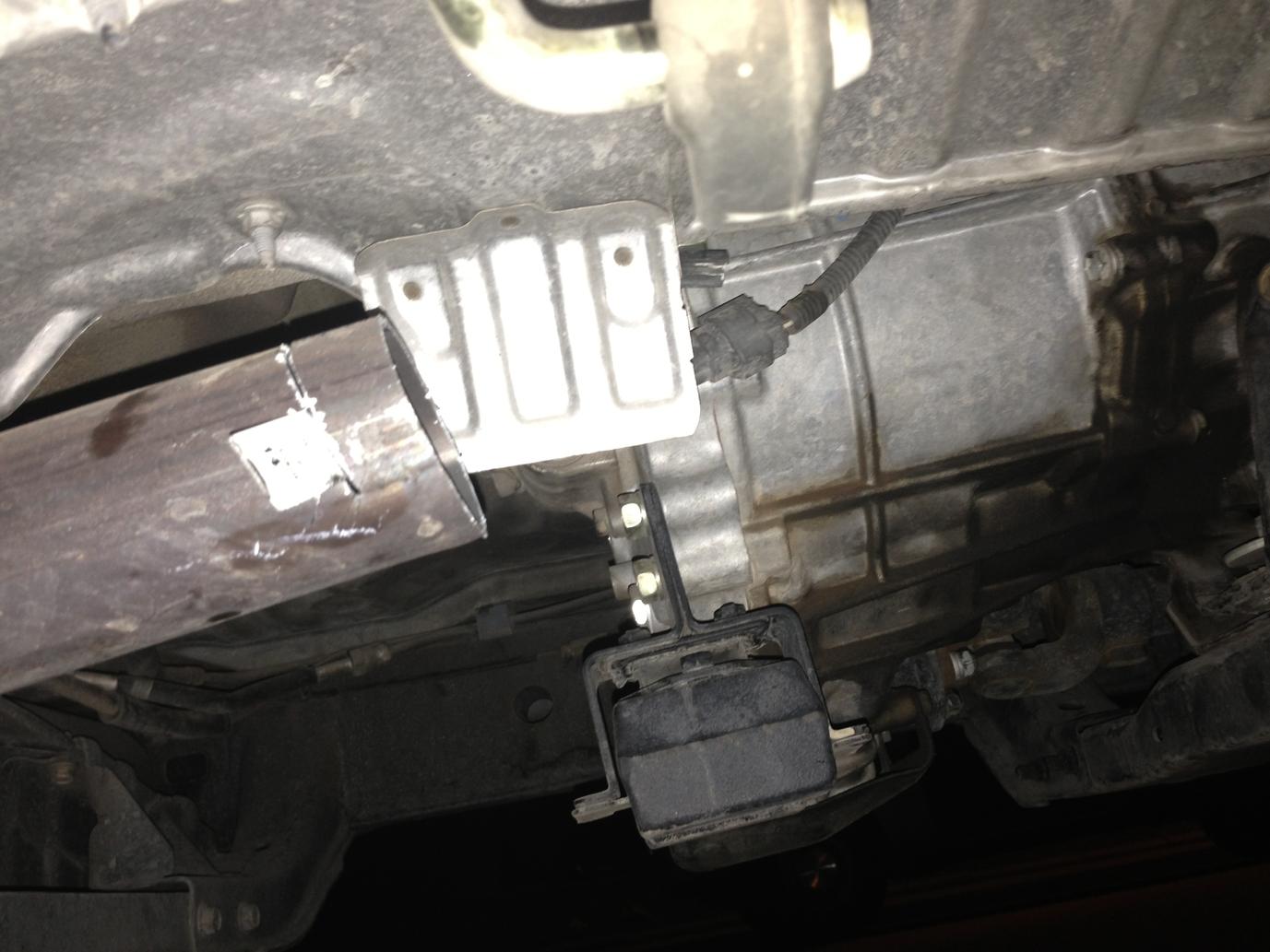

So funny story I'd like to share with my fellow runners. A few weeks ago after I had gotten off of work, already having a horrible day as it was Monday, I jump in my truck and start her up and it sounded like a big block v8. Sounded pretty cool at first but that was short lived as I knew someone had done something. I get out to check out my exhaust and some had cut out my cat while my Truck was parked in the parking lot at work!! They climbed under and used a sawzall to cut it right out! Anyone had this problem before and how I can prevent it? I mean it's not super expensive to replace but it is quite annoying. Ill try to post some pics but I'm on an iPhone right now. You can see they broke one blade trying to cut it out. Gotta love idiots.

dude, damnit, those Bass turds , now you have an excuse to do a cat-back system. hope you get it all worked out.

Only way to prevent it is to make it hard for them to get or make it look harder than one down the street so they move on. Same idea as the Club steering wheel lock. You can buy a catclamp, skid plating (or make your own). I made up a cheap visual deterent using some exhaust clamps and chain to make them cut through something thicker than just the exhaust tubing.

Yeah I've had decent luck with the cheapy generic cats and they last me a long time, and I do my own welding so I don't need to take it to a shop, but I agree oem cats plus the work the shop had to do with welding can cost anywhere from 1200-2000$. I'm thinking of some kinda storm mesh I can wrap around the exhaust that would make usin a sawzall very difficult, ill let everyone know my idea when I figure it out :)
