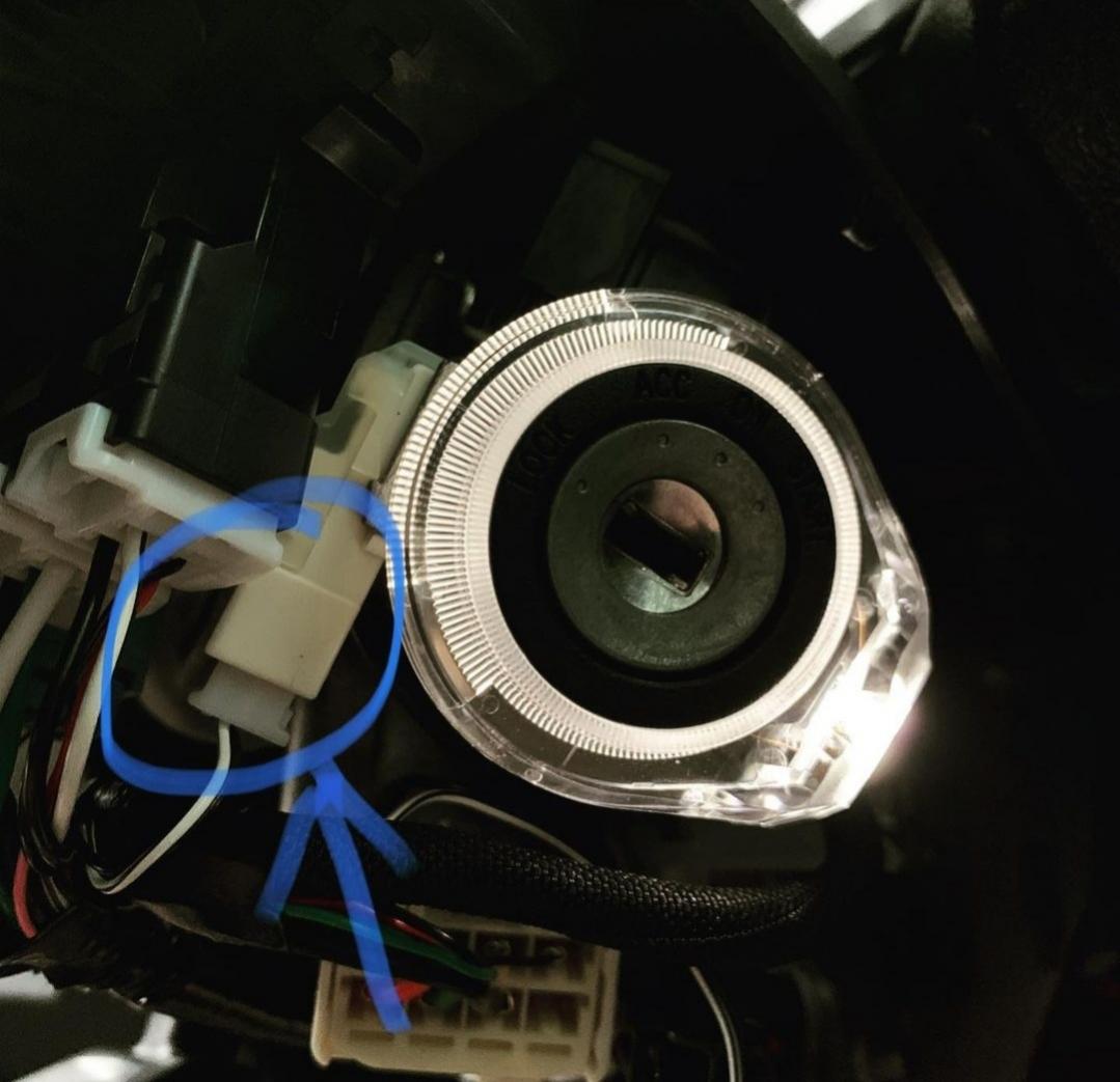

Trying to stop the "open driver door, then turn off ignition" ding.
My Carista OBD reader arrived today. Selected disable "key left in car" ding and it appeared to save, but the it still dings when I start the car, open the door, then shut off the car.
Is this the right "ding" to disable? Is there another option I need to disable? Am I not saving changes correctly within the app? Can Carista kill this particular ding? Do I just need to get into the habit of shutting of the car BEFORE I open the door?

Carista disables unbuckled seatbelt ding. But not key left in ignition key ding. See post 4 to disable that. You need to unplug a connector.
