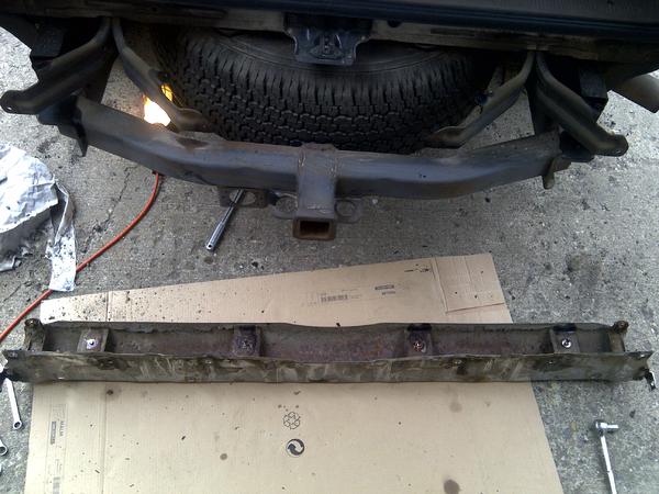

Finally got to it!
Well, the weather is starting to change so I decided to get down to my rust treatment.
First, the rear bumper (the most common area for perforation)
http://www.toyota-4runner.org/membe...ng++rust!-picture13850-first-step-backend.jpg

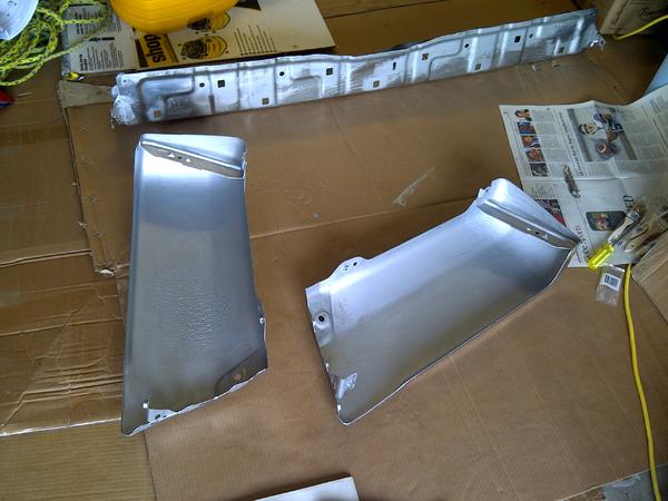

Then after Rust Bullet...
http://www.toyota-4runner.org/membe...ing++rust!-picture13693-after-rust-bullet.jpg

Then the front bumper...
http://www.toyota-4runner.org/membe...treating++rust!-picture13792-almost-ready.jpg

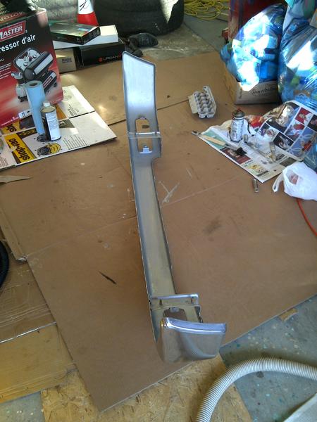

Rust Bullet...
http://www.toyota-4runner.org/membe...treating++rust!-picture13789-front-bumper.jpg
Aside from snapping a few bolts and nuts it went pretty well. Everything went back without much of a problem. I did find with the front, when removing the plastic skirt, care had to be taken not to damage the bolt holes/clips.
