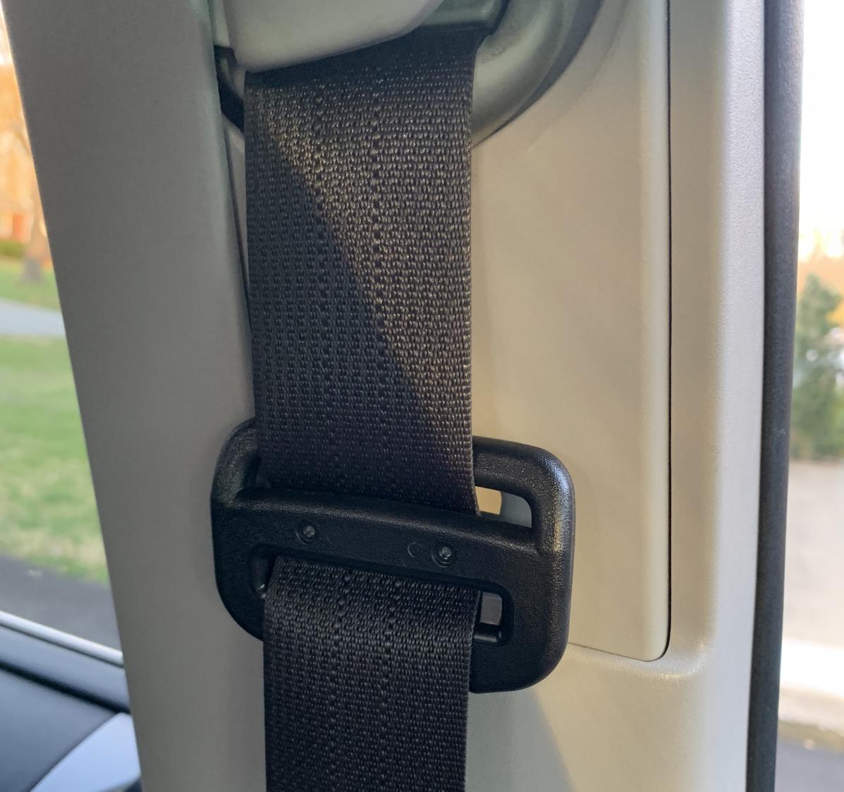

I was in my 2016 Limited when I noticed the drivers side seatbelt is inside out. I checked my wife’s 2015 TP and it’s the correct way. Wtf?

It happens. I've had that happen several times in several vehicles over the years. Are you left handed by chance?
Just fold the strap below the buckle in a triangle (like how you'd fold a flag), and slide the buckle below that. It might take a few tries, but it's easy...

I’m right handed. I’ll give that a shot though. Thanks

Cool. Just curious, I'm left handed and have had to fix reversed buckles maybe 20-30 times over the years (I'm 50). Thought that might have something do do with it...
Just make sure you fold in the right direction, or else you'll have to do the same thing 2 more times. You do not want a half-twist in your seatbelt strap.

Got it. Thanks man
