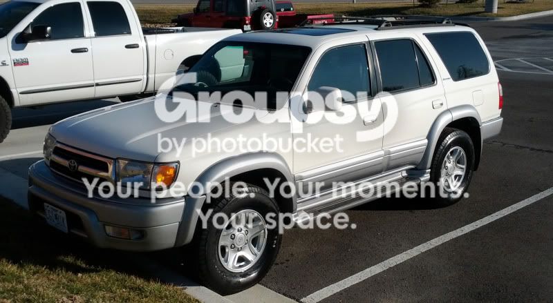

A little update. Got it all flushed, inspected, licensed, & back on the road. Drove it to my hospital clinical yesterday and then to work today. So far, so good. Just pulled it out of the fire bay where I had cleaned the inside and outside. Still got to order the hood cable and rear latch. Only other thing left is to figure out why the electric door locks won't lock. Have to lock it manually. Any clues?
looks nice how much did u get it for? also with the locks dose it make the locking sound when u push the locks or nothing. It maybe a power issue
It was cheap. Family friend cheap. Lol.
The locks don't make any noise when I try to lock them. But the switches will unlock the doors.
