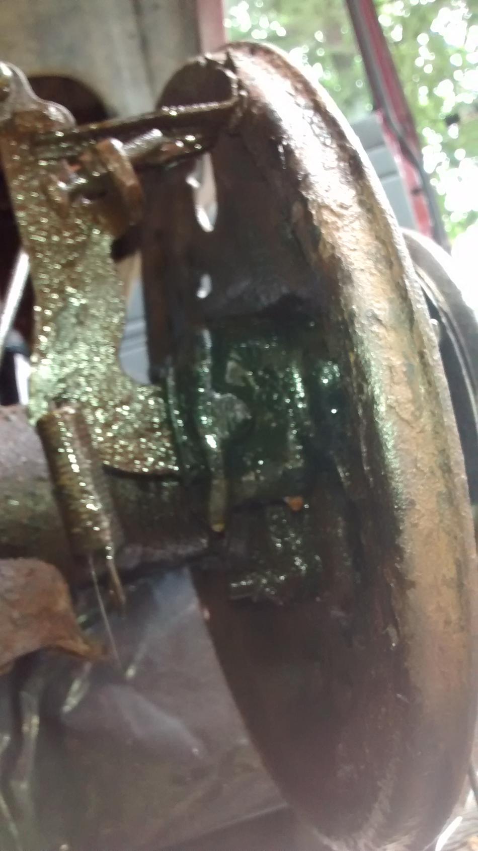

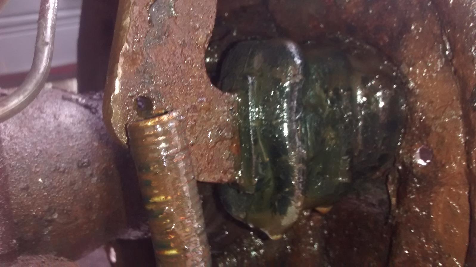

1989 Toyota Pickup DLX. 4wd
Just completed Rear Brake's
(1) Shoes, Brake Hdwr replace.
What preempted was RR frozen rusted
Emergency Brake Lever - which would not
move at RR wheel Brake assy.
Broken Rusted Bolt on Emer Brake Lever
Bracket on removal.
Drill out of this broken bolt - left
Only 3 good threads. Attempted Re-tap of same
M8 X 14 mm X 1.25 pitch bolt failed.
(2) Repair of stripped Emer Brake
Lever Bracket bolt Thread hole
which was stripped by over drilling
angle.
Fix - With only three, four good threads
remaining. I drilled out a slot in Rear of Emer
Brake Lever Bracket for M8 X 1.25 lock nut addition. Medium Thread ( blue) lock sealant to both of these Bracket bolts.
Bracket feels secure as original now !
