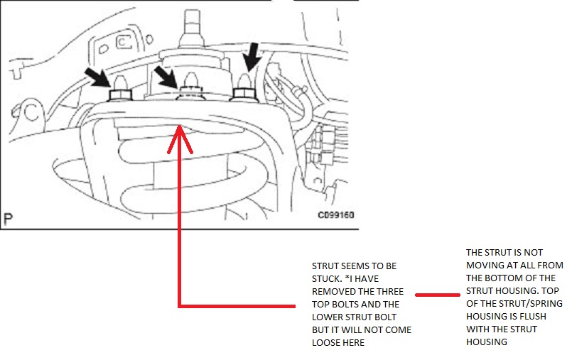

Ok I dont think in anyway I have destroyed the strut but a photo from another thread I will edit in paint and post on here what I am having an issue with.
Best I could edit and play with. Hope this helps someone help me. Please. Thank you.
BTW as I stated the lower control arm/a arm would not move with not amount of force I placed on it with out loosing the lower control arm/a arm bolts.
Also if I remove the sway bar and other bars around to help for more room, do I need a pickle fork to reapply the joints to tighten it or can I just tighten it back together?
PEOPLE PLEASE REPLY ASAP AS I WILL TRY AND ATTEMPT THIS TOMORROW. THANK YOU

If you can get enough room, you need to try to pull the bottom of the shock out and away from the vehicle. Once you remove those three nuts and the lower bolt on the shock (after taking out the bolts for the lower ball joint and removing the swaybar), you should be able to pry down the lca and pull the bottom of the shock out.

But it looks like you are using the stock jack to apply force to the upper arm SO how does this help getting the strut to pull out if it is stuck?
Pushing the upper arm down will also push the lower arm down and it should give you enough room between the lower strut mount and the strut eye to push and pull horizontally to wiggle the strut out.
It may also be worth trying that method (with the jack) without removing the lower bolt, that may cause the LCA to pull the strut out of the mount.
