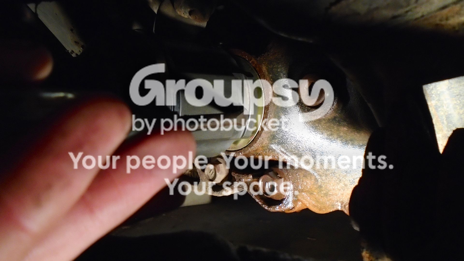

I just sledge-hammered it out with a burly screwdriver (in the opposite direction of the pic though)
