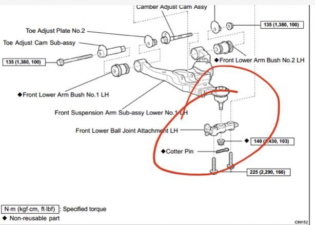

I’m trying to change my LBJs
The steering stop attachment (I can’t find a name for this part except this) is stuck. I’m an hour or more round trip to get a pickle fork.
I can’t get it to drop. Have gently tapped it while prying hard!
Have it soaking in Kroil.
Anybody got a solution?

Your pictures won't open for me, I assume you are talking about the piece held on with 2 bolts that will release the LCA. It should come off fairly easy but I recall having to apply some heat on one to get it to separate.
Replacing the LBJ is a big job, I opted for new LCA from 1Aauto that come with new LBJ and are about $200 per side. They come with new bushings too.

If you're replacing the ball joints, easiest way is the destructive route since you don't need them anymore. Cut the ball joint taper between that intermediate attachment plate and the LCA. Then use a ball joint press to pop out each fragment. You'll need a nice carbide sawzall blade because the material is really hard. I used diablo carbide speed demon for thick metal blades or something along those lines

Thanks. That’s the one.
I only do OEM. Have 555 OEM ball joints and the press ready to go.
May try heat.
