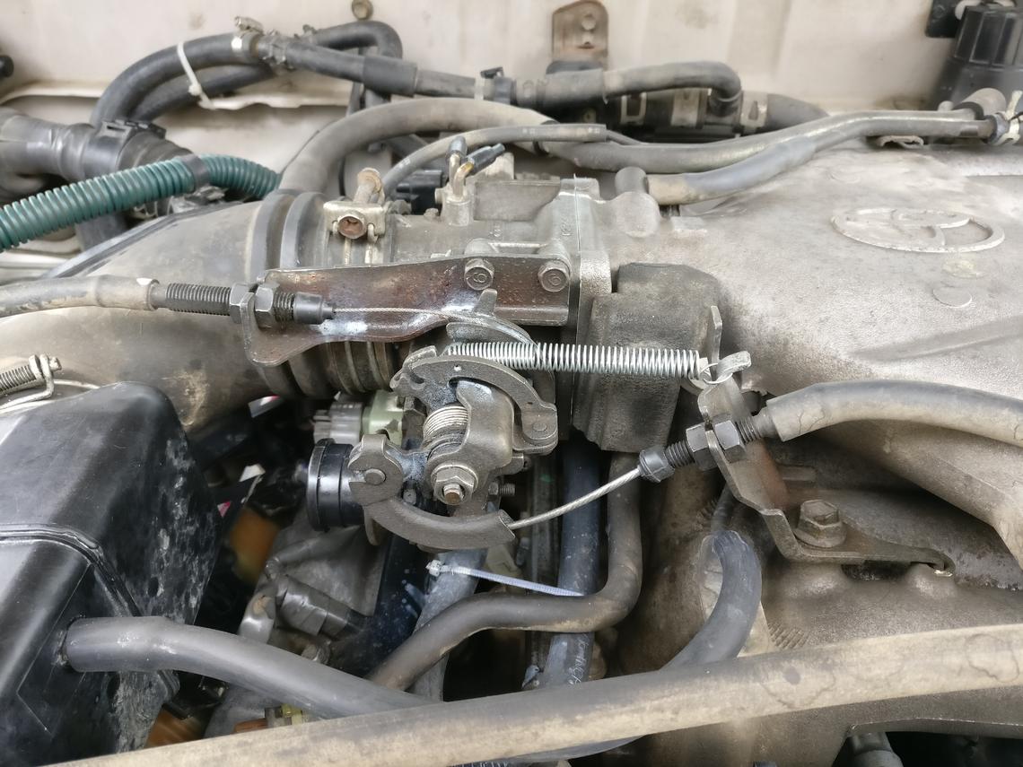

That's how I mounted mine. It's been idling fine for over a year now.
This is my return spring setup. I would make it more inline so it doesnt rub on other components. It's better to start wih a lighter spring so that it doesnt affect pedal feel. You'll need to do some tweaking to get the tension just right.

On a side note, I threw the spring on and it pulled the idle down to 900 rpm... we may be onto something herep

I added the same spring. It pulled the idle down to around 900 consistently. I am going to try the washer trick this weekend in hopes proper plate alignment will help a little!
