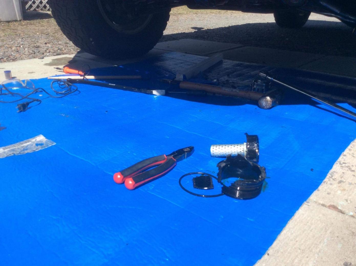

I had all of the non-threaded portion break free, and the threaded portion remained in place.
I was extremely worried that I would damage the threads of the engine portion (it's actually not part of the engine block, but another piece)...as I watched someone with an avalon destroy their engine block online by cutting away with a dremel and tearing up those threads-- I wound up finally breaking the inside threaded portion free by spending an afternoon with an old soldering iron scoring and melting through the plastic. it took more than 2 hours.
It had occurred to me that a hot soldering iron near oil on the underside of the engine was not safe or healthy-- but by that time I was ready to meet my maker.
