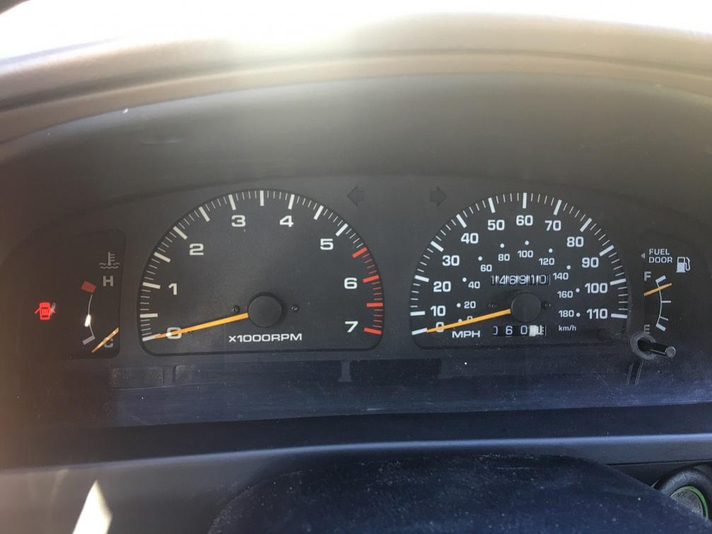

So - doing the 5 speed swap in my 1998 4Runner and have a stupid (?) question regarding the tach... my tachometer has the gear position indicators built in and they are annoying as hell.
So I just wanted to verify that the factory manual ones have a different tach without the gear positions.... also - does anyone know what year / model swaps over without issue? (ie 1996-1998 manual 4Runner or Tacoma)

Thanks guys - ended up finding what is advertised as a 98 tach - no gear indicator lights so spent the like <$20 for it - should be here soon - worst case I'll swap the PCB and movement from mine to that face
I did an auto-manual swap on an old Honda Accord station wagon for that I kept my gauge cluster and just pulled the bulbs for the gear indicator section and swapped the faceplate from a junk yard manual cluster into mine to cover the gear indicators. I don't have a manual 4runner cluster to reference but figured I'd throw the idea out there. That way you can keep your original miles.
Well - swapped it over - works perfect. The PCB had the same number as the outgoing auto version - the auto had the gear indicator module - simply left the plug disconnected. tested and everything works correctly and reads accurately
