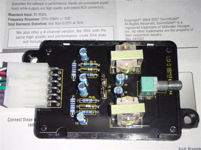

Sound Gate LOCX 2- Line out put converter (85 watt, 100HZ Low Pass)

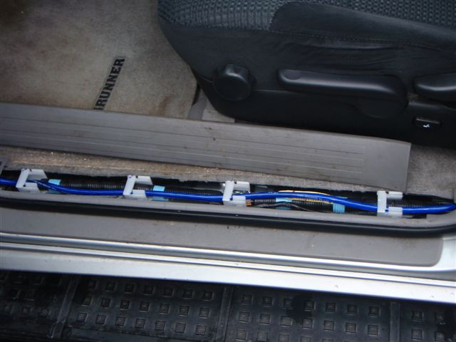

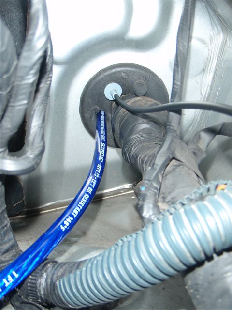

Routing cable - amp location is the drivers side seat, leaving the passenger side for a potential 4 channel amp.

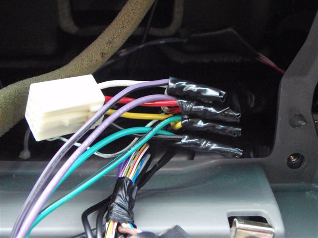

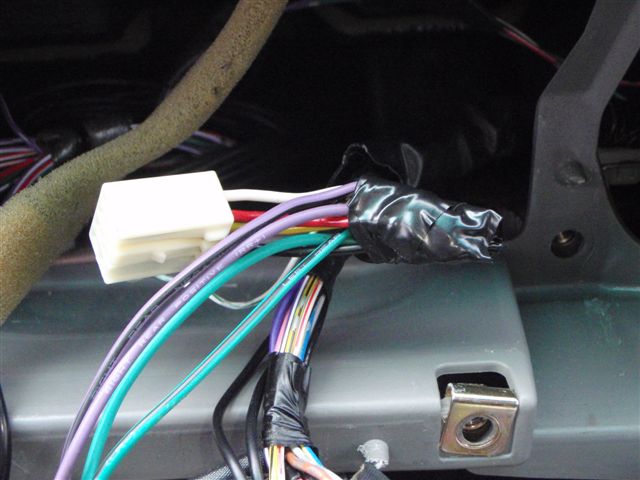

LOC Pic #2 - I tried to solder but, when that was unsuccessful, I just twisted and taped.

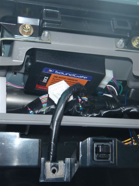

The LOC is tucked under the navigation system, so I can tune it without taking out the deck again.

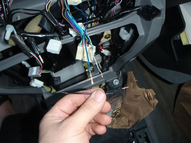

Great post. Where did you pull remote wire for the amp? Did you have enough space under the seat for the PDX amp?
I tapped the remote wire behind the harness. It takes some time to take off all the extra tape, but hopefully I did it correctly (oh my back)
I stripped two sections of the remote line (that goes to the amp) first a 1" long strip (at the end) and a 1/2" length about 2" up. That leaves two sections of 1/2" sections of exposed wire.
The point of this was to add a little bit of slack to the stock wiring harness. One end of the remote wire gets twisted to the line going to the amp, and the 1/2" area higher up is where I twisted and taped the other end of the remote line.
I don't know if this was the best thing to do, but after cutting the remote wire, I just wasn't comfortable having the stock harness shortened because of the cutting and twisting.
Sorry, I forgot to take a picture of this step. I hope I did a good job explaining this.
Please use a butt connector if you can't solder the ends. Twisting and taping is so unsafe. Nice gear though!!!

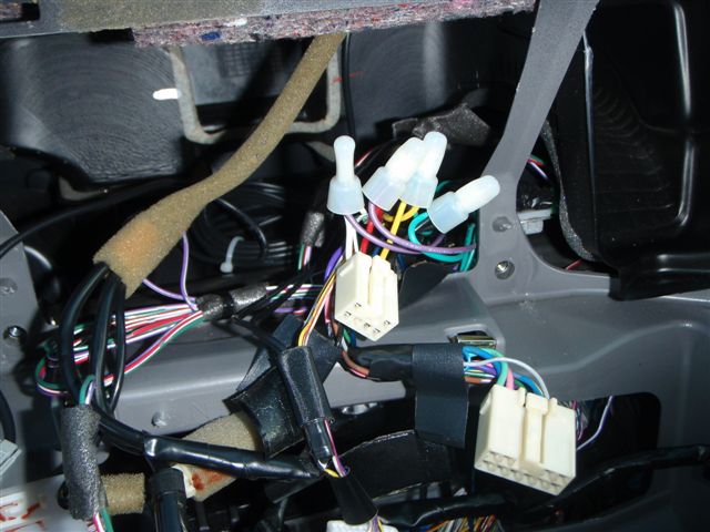

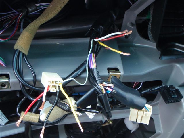

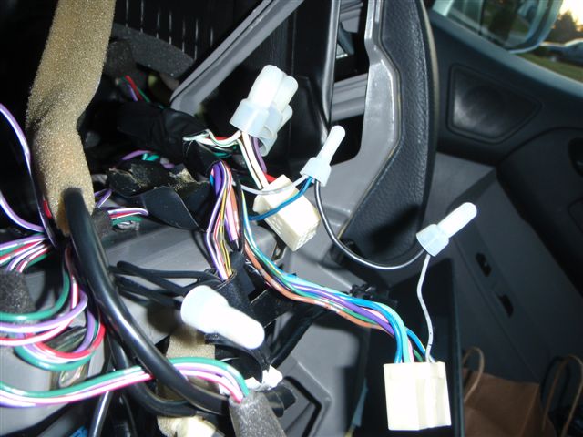

I just finished re-wiring the harness with crimp connectors. I thought my twist and tape was pretty secure, but here's a few pics I took tonight.

Tapping the remote wire with a little extra room to work with.
