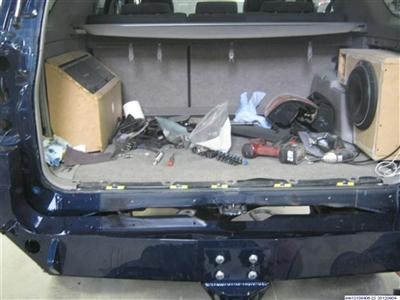

Sorry for the bad picture but its all I could find at the moment

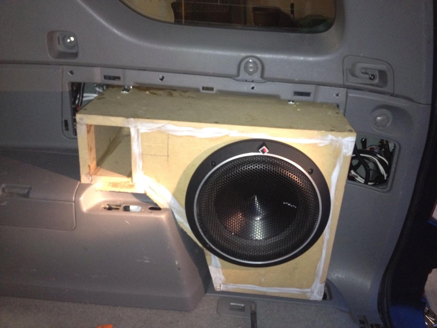

I have this Rockford 10" powered by a punch amp and it is turned down on the deck to -8 and it still pounds hard
Plus I didn't loose too much space people can't believe it's just a 10" until I show them

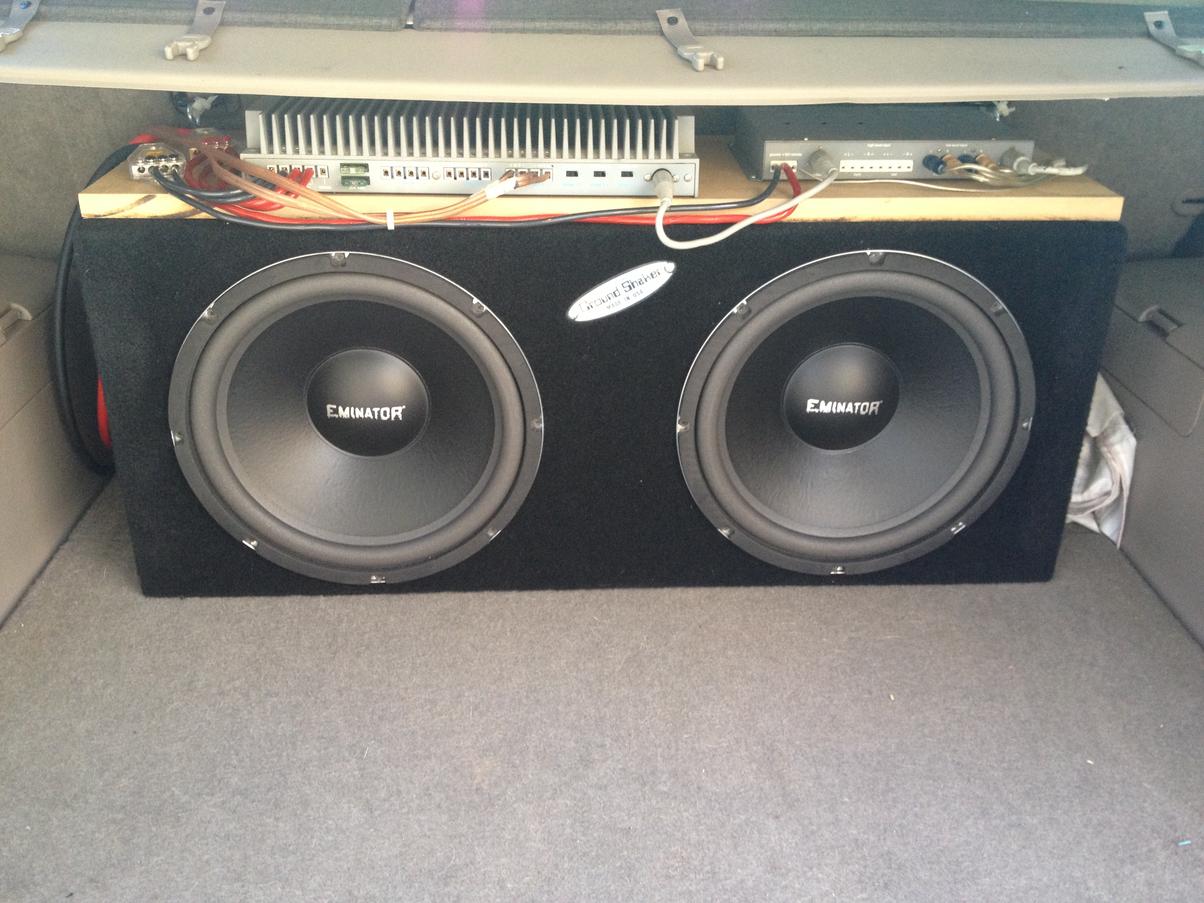

This is what I ended up with
See the attachment for what I ended up with, went with the 12" eminators and a prefab box, it fits pretty well and I've cleaned up the wires a little since that pciture.
