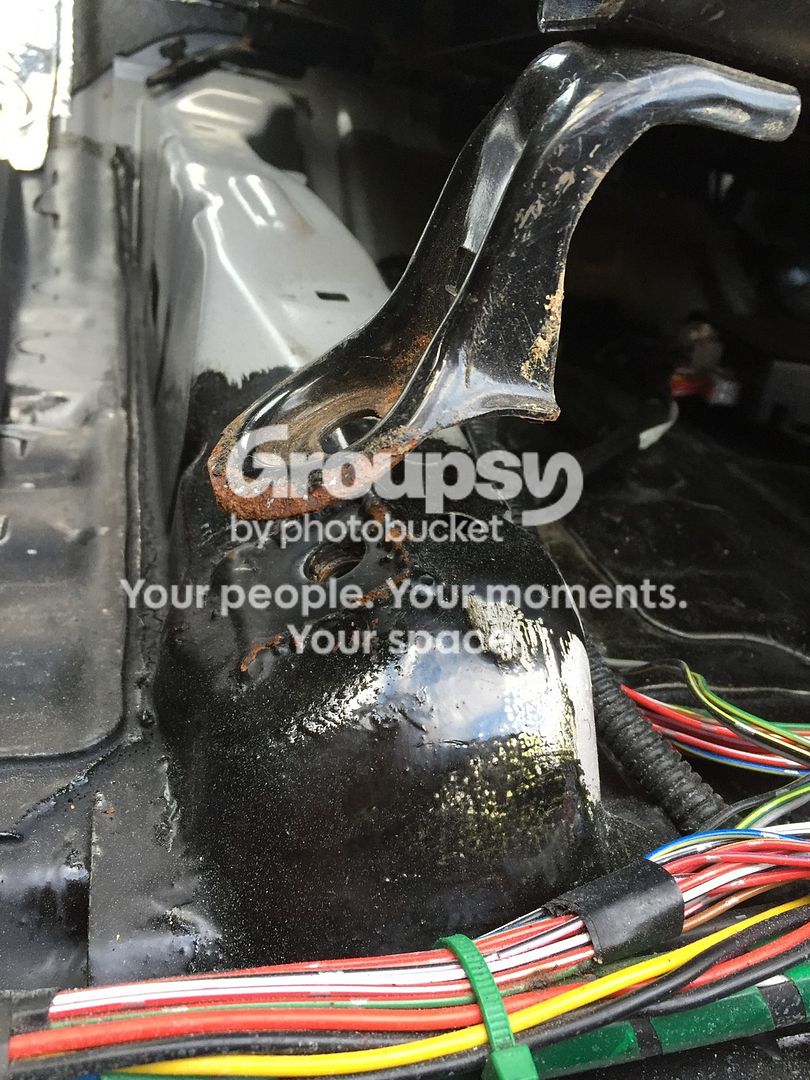

Has anyone managed to do a simple fix where you bolt it down with a washer and put some locktite on the nut?
More importantly how do I access underneath where the bolt rusted out and fell down into? I know I gotta tear up the carpet and everything, but it looks like it goes to an area that is inaccessible. Help?
I had commented on this thread about 5 years ago with the same problem. I ended up using my Dremel and cutting at square hole 1" X 1" on the back of the cross bar to access the nut. I then held the nut with needle nose pliers while I tightened the bolt from the front. Worked like a charm. You could probably use a drill bit and a jig saw to cut the same sized opening if you don't have a Dremel. No welding involved, and is a good alternative to drilling through the floor.
My fix , flat washer with nut welded on the washer then the washer welded in place. After cutting the old shit out.
