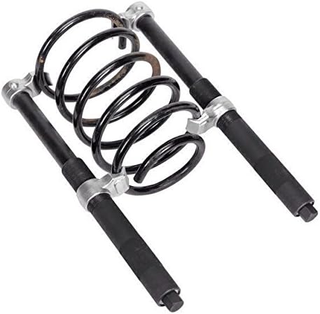

Also FWIW - on the rear springs, if you're comfortable around spring compressors - this is the only style I've found that works well for the rear. With these, you can swap rear springs without taking any other parts apart, just jack up the rear by the frame and support with jack stands so the axle is unloaded as far as possible (usually for me that means jack to lift under the axle, jack stands under frame rails, remove rear tires, and lower until weight is fully off of rear axle). Then you can simply compress the coils and remove them without having to disconnect any suspension components. I can swap rear springs in about 20 minutes. Other style spring compressors where the threaded rod goes through don't work for this. The threaded shaft will hit the bottom of the cab before you can free the springs. Or you can just drop the axle further as the alternative, but these make it a really easy job.

Thanks. Good info. I like the spring compressor idea. This prevents you from having to disconnect the KDSS sway bar when swapping out springs or installing a spacer? It looks tight at the bottom of the spring where the mount is. (I was looking at it this weekend when installing the Sumosprings. (which seem to work well. No noticeable roughness during empty driving but when I put about 450 lbs to test it didn’t squat near as much.) Those compressors fit and then allow removal of the rear spring? Could they be used on the front struts as well to prevent having to remove the sway bar up front as well?

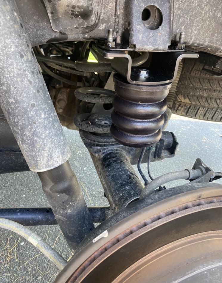

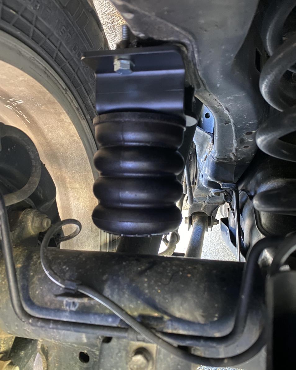

Here is a pic of the sumosprings installed while up and one after on the ground showing he unloaded distance between the axle and the helper springs. It was super easy. Did it while doing my brakes which was also easy. (Front is awesome. You don’t even have to remove the caliper! OEM brakes lasted 67k miles!)

They worked great. Only on rare occasions did I feel like they affected ride like going over bumps or something. Definitely helped support heavier loads and tongue weight. Great alternative to airbags but may not be as good in every situation.
My issue, I have since lifted my 4 Runner so now it must sag an extra 2” before it hit the axle so I am working up a fix. Temporarily I put a large stack of fender washers to lower it. It actually worked pretty well but isn’t what I want permanently… It allowed me to tow a camper with around 450lb tongue weight and helped a lot.
