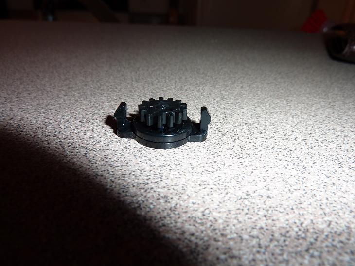

You guys were right. I took it apart and the little gear piece had come out somehow. At first I didn't see anything, but then realized it had flown out and onto the passenger seat when I got the console to break free. Additionally one of the clip tabs had bent and was on the verge of breaking off completely. I have since added some CA glue and it seems to be strong again. We will see when I try to clip it back in place. Fingers crossed...

Anyone have an extra one of these?
I had the same problem with the door on my roof console. The above photo shows 2 clips (one on each side), Somehow, one of the clips on mine broke off so there is no way for it to stay attached to the unit. I've been looking around to see if I can buy one but it seems that the only way to get one is to buy the whole roof console. Does anyone have one of these laying around, or know where I can find one?

Does anyone have a part number for this? Dealer said I was going to have to buy the whole overhead console.
http://im.toyota-4runner.org/attach...717890-sunglass-compartment-fail-gearclip.jpg
My sunglasses holder also broke the same way. I carefully glued it in place with super glue and so far it's fine. It's been about a month or so.
