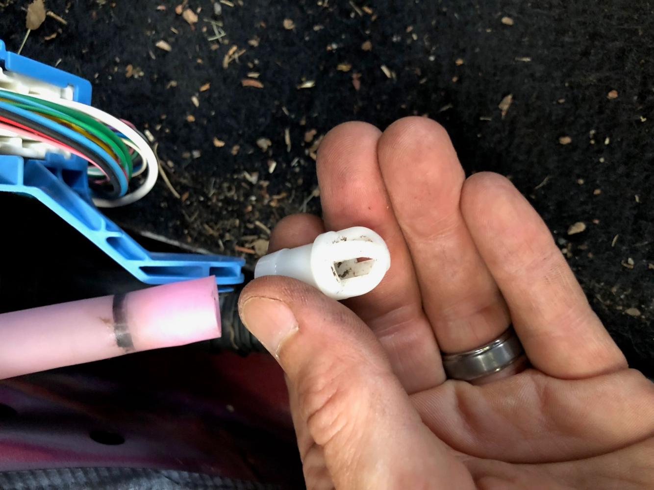

I couldn't find much info about where the 5th Gen sunroof drains come out. I knew they came down the A pillars and somehow out the rear (Just like the 4th gens, there's one run through the tool area in the rear). My sunroof was holding water so I knew I had a clogged drain. Turns out it was 1 of 4 that was clogged the others seem to drain out of the pinch welds with no access to the "exit end" - Toyota this seems like a horrible idea.
My Front Driver drain was the one that was giving me issues so I spent a while trying to track it down. I had tried the weedeater string, and even a coated braided steel cable. It seemed to run the same length down each side before bottoming out so I wasn't sure what was causing the clog.
Once I stripped away some of the panels and electronics I pulled the hose out to find the small "filter plug" on the bottom. This is what was causing my tools to bottom out, and it's also what was causing the clog. Mine was packed full of debris. Figured I'd share a photo in case anyone else is having a problem tracking them down.

I have a 2011 SR5 4Runner with 165,000 miles and I love it! Never a problem with the exception of general maintenance, most of which I perform myself. Recently I ran into the same problem as most of you here. Mildew/Mold smell and water on my floor. I'm going to share a thorough explanation on the cause and how to fix it.
Contrary to other posts I've read, car manufacturers do expect your sunroof to leak. With the inevitable dirt/pollen corrupting the seal of any sunroof over time, the manufactures designed a drainage system to redirect the water. There will always be four holes in the sunroof connected to drain tubes directing the water out and underneath your vehicle. The cause for the water on your floor is these drain tubes get a clog and the water can't escape causing a backup that spills out of your sunroof and down onto the headliner. From here, it flows down the pillars, usually the A pillars and down under your floor's carpet where it seeps up and smells.

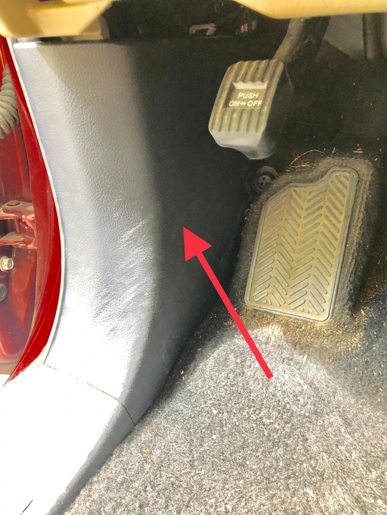

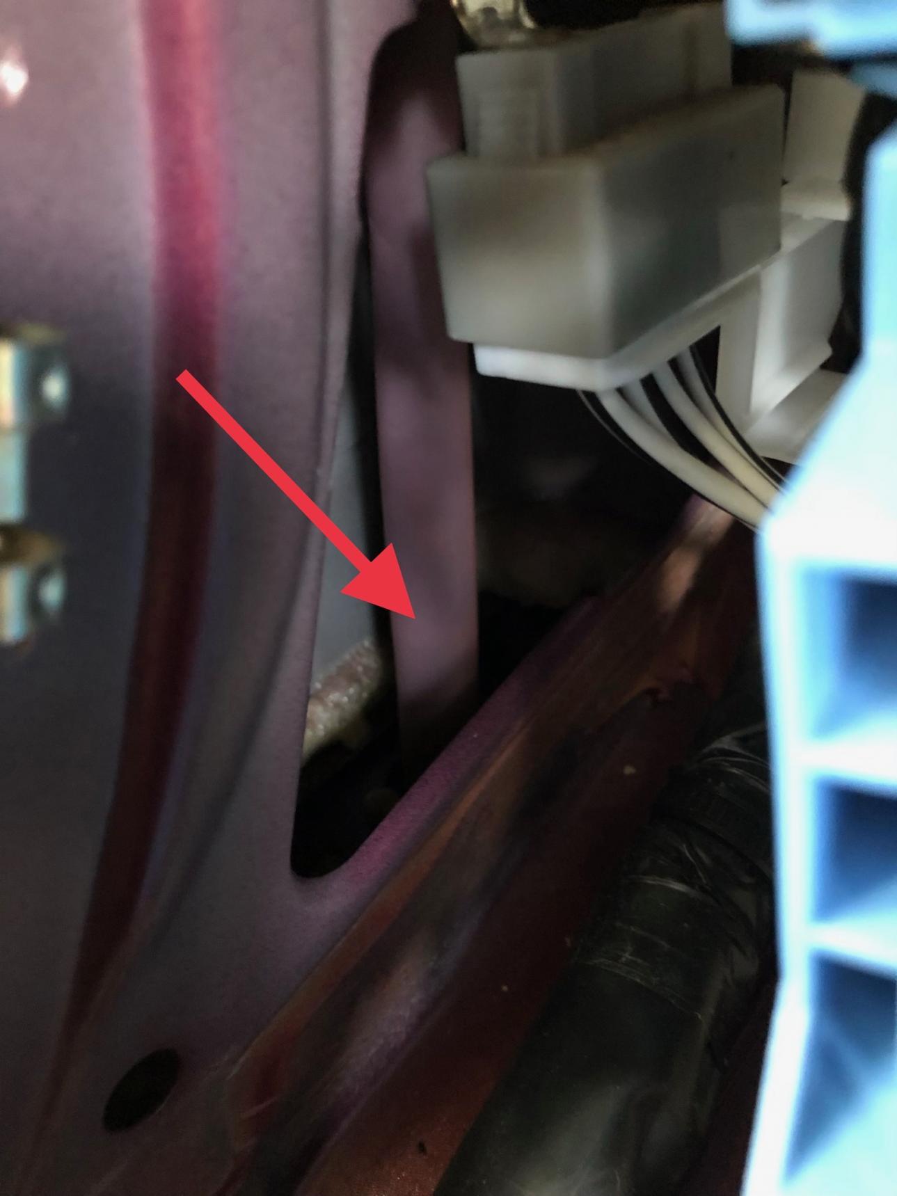

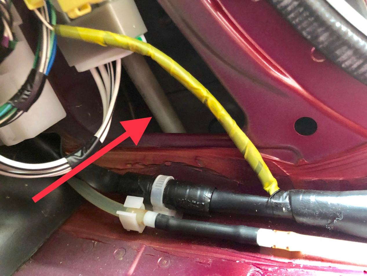

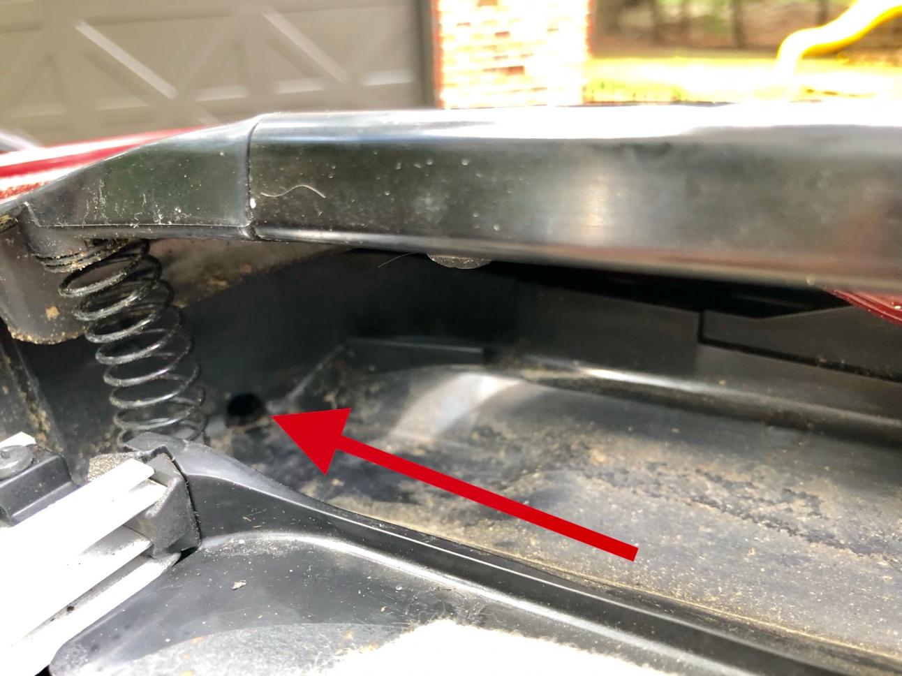

To fix it, you'll need to remove the running panel at the bottom of your doorway. Then unscrew and remove the triangular panel found to the left of the foot rest on the driver's side and under the glovebox to the right on the passenger side. You'll find a tube (each tube is color coded to reflect which sunroof hole it should be connected to during installation), driver's side is pink on my 2011 and passenger side is white. Pull it up and out of the hole where you'll find them. Pull out the white filter plug at the bottom of each front tube and clean them. Don't reinstall them yet. Open your sunroof and locate the front left hole and the front right hole. Take a sheathed 14 to 16 gauge wire, thick weed whacker line, or better yet, curtain wire (https://smile.amazon.com/Shappy-Meter-Curtain-Self-adhesive-Hooks/dp/B075LHFBVX/ref=sr_1_8?keywords=curtain+wire&qid=1566928050&s=gateway&sr=8-8[/URL]) and push it through the holes until you see it come out the bottom of the tubes. Rake it back and forth several times before pulling it out. While keeping the tube bent and pointed outside the vehicle's door, poor a couple quarts of water down the front holes in the sunroof. You may want to use a funnel for this. Replace the white drain filter plugs and reinstall the tubes back into the holes where you found them. Poor more water down the drains and ensure its emptying out the underside of your vehicle. If you have an air compressor, put an extension with a rubber tip on your blow gun and blow out the lines using around 30-40 PSI. Replace all the paneling you removed.

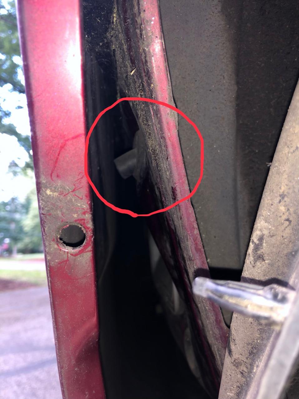

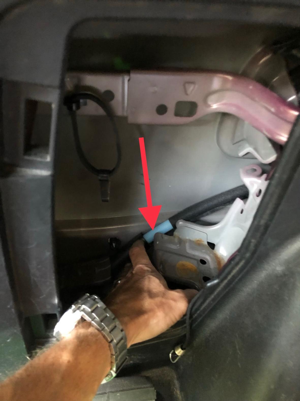

The rear drain hoses are a little more difficult. One cannot reach the drain holes to the rear of the sunroof from the sunroof opening so they have to be cleared from the exit ports. The end of the left rear hose is simple if you have a Gen 5. Its location behind the pop-out panel where you would find your truck's jack. The hose is blue and can be accessed simply by popping it out of its black fitting. Run your wire as far as you can. I actually had trouble getting it past 2' as I believe I found a significant bend in the tube and the 14 gauge wire wouldn't bend past. Curtain wire would have definitely worked better but I decided to use my air compressor to blow out the line instead.

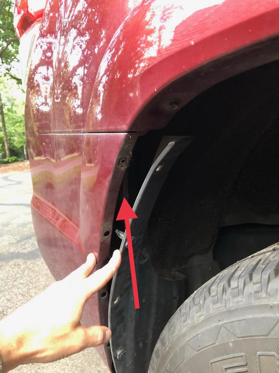

The right rear drain hose was more difficult to locate. Found it by removing the guard panel in the wheel well located adjacent to the right rear fender. After removing this, you'll find the drain hose exiting between the fender and the inside metal housing. Because of a significant bend in this hose, I once again had trouble getting more than 2' of my wire into it. I defaulted back to my compressor to blow out the line. It’s helpful to have a helper on hand who can either blow out the line while you listen at your sunroof for compressed air or have them listen while you blow it out.
