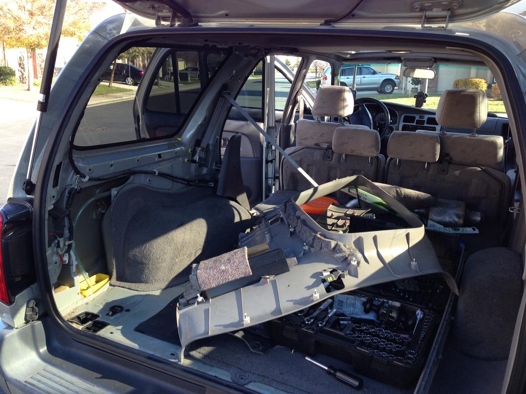

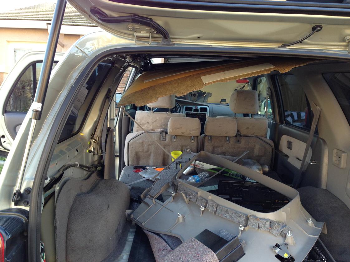

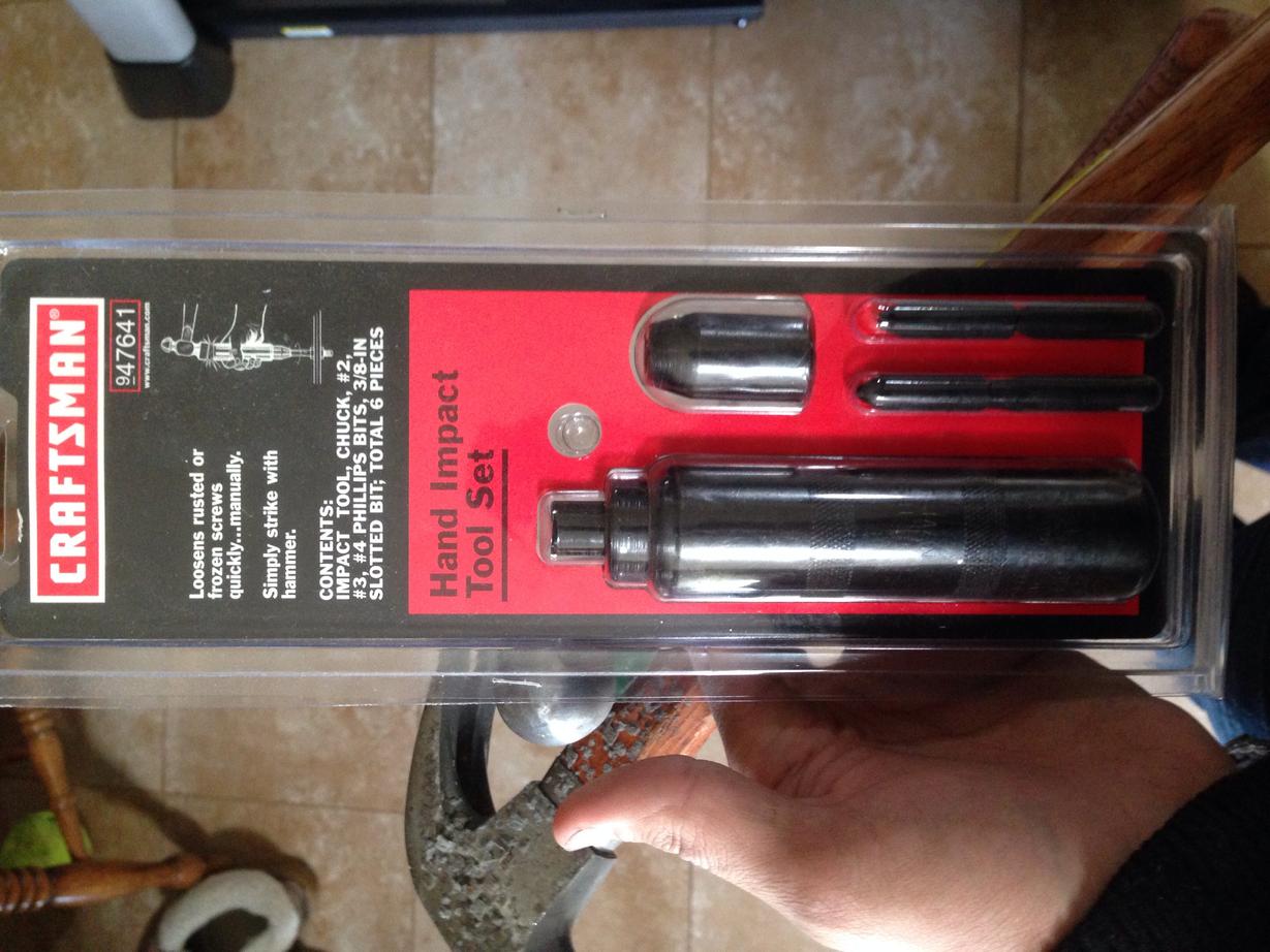

Sorry, I didn't have any write ups to follow. I just got to work. Basically you have to start at the rear hatch. Remove the door sill plate then pull the upper plastic that the hatch dome light mounts to. Then you can pull the side cargo pannels off (if you have the cargo cover, unscrew the cups that mount to the pannels) and if you want to completely remove them you need to unbolt the rear seatbelts, then remove the rear passenger grab handles, and the plastic panel behind it. Then unbolt the drivers seat belt at the adjustable shoulder point and pull off the panel behind that(I had to pull off the lower panel also where the seatbelt goes in to get that panel off). Then remove the drivers grab handles and panels(including the a-pilar handles) BE CAREFUL to not strip the screws in the handles, they are soft heads and in there really tight. I suggest using some type of frozen bolt removal tool. I used a tool that has interchangeable bits with a hammer powered rotation so when you hit the back it forces the bit into the screw and rotates it simultaneously. Or you can just pound a flat head into the screw and order new screws. Lol once all those pannels are off you need to remove the drivers map lights and entire panel. Then remove both sun visors and the overhead light above the drivers center console. That should be very thing and the headliner should just about fall out…I'll attach a few pictures of half of my headliner dropped from when I did mine.
