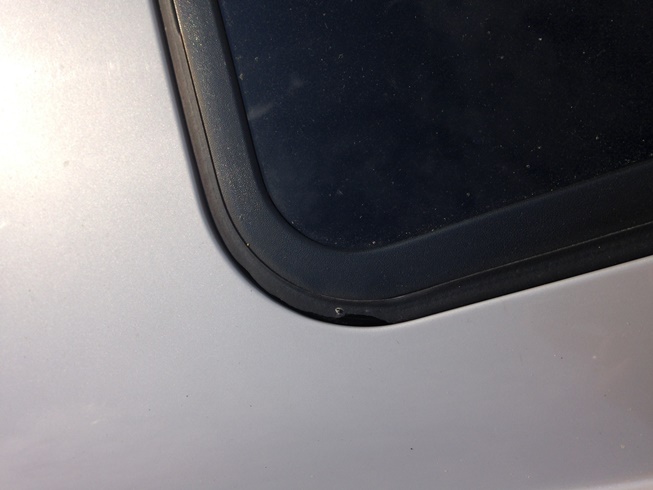

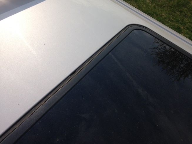

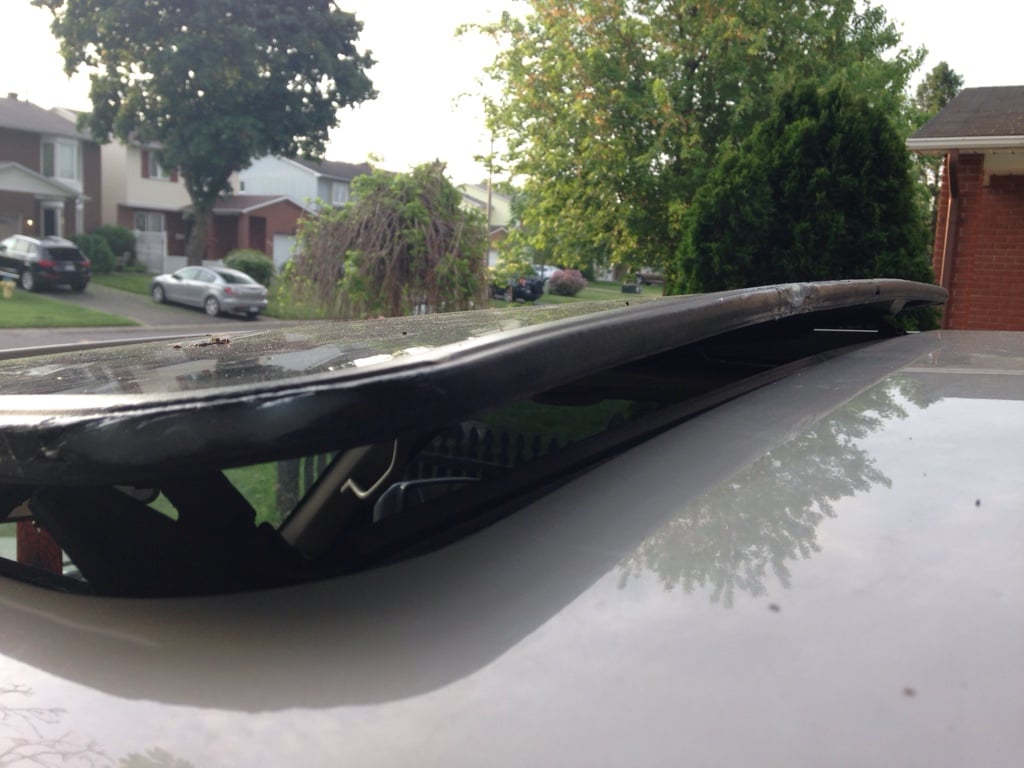

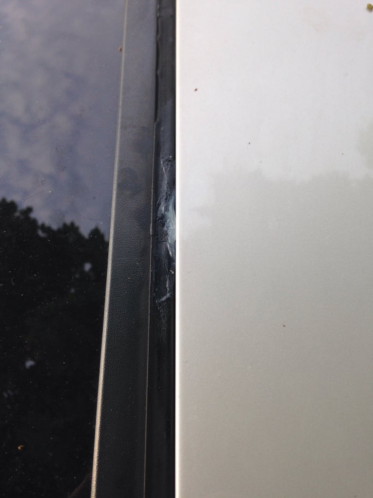

So I noticed that the weatherstripping on my Sunroof glass is pretty messed up. I have 2 chunks gone/rotted off the top/outside portion. Never noticed a leak though, so I'm guessing that the drains are keeping up.
Naturally, I don't feel like spending 600 bones on a new glass/weatherstrip. Do you guys think it's safe to use a clear waterproof silicone to "fill-in" where the weatherstripping is broken?
Snapped a couple of pics. I gotta get some clear silicone and fix this ASAP. I don't wanna have to condemn my moon roof though.

You might try and put wax paper or cellophane between the silicone and the roof, then at least it's still functional.

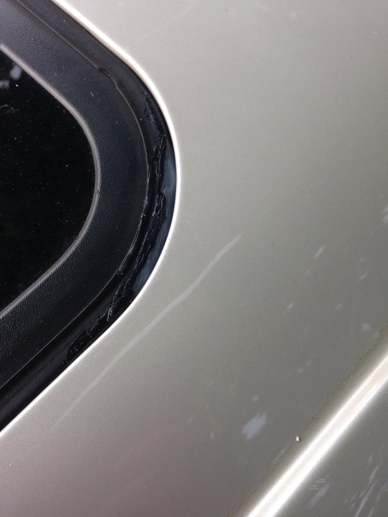

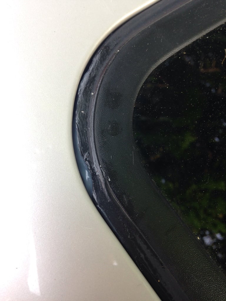

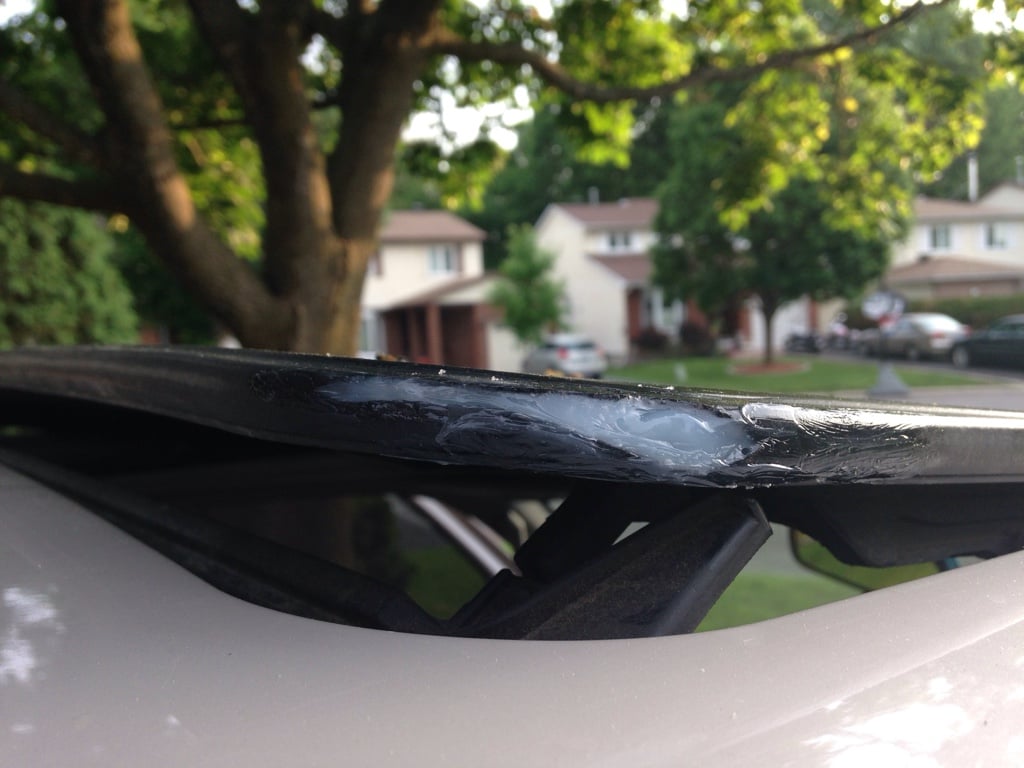

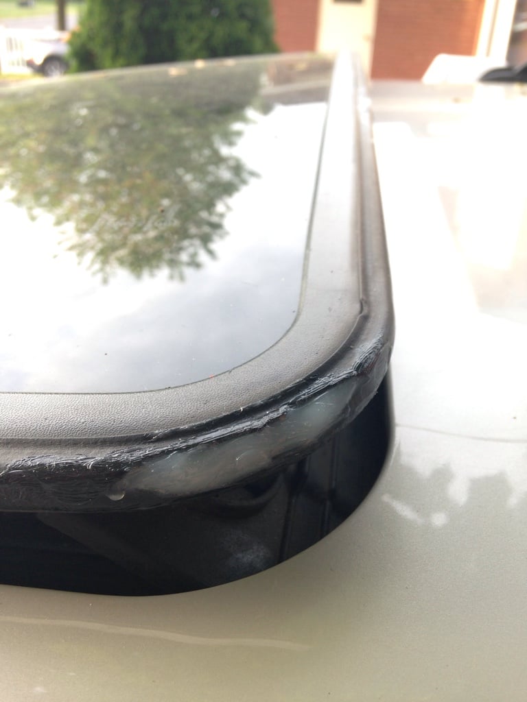

Update: I got some gutter & flashing 100% Silicone and filled the missing chunks. I don't know if this is a wise idea overall, but hopefully it works. Like I said, There was no noticeable leak inside the truck before so i just assumed the drains were doing their job, but maybe this will prevent bigger headaches down the road. I dunno.
Tilt and Slide functions still work with no visible catching or stress on the seal.
I'm not exactly sure what original tore the seal. I don't think it's rot, because the rest of the seal is still in a nice malleable state and doesn't feel brittle.
Maybe the rig's previous owner tore it on some branches.. I have no idea.
