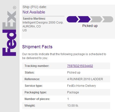

BTW - Can someone guestimate the weight of the ladder?
Dug through my inbox. I knew I filed this stuff for a reason... the email I got from FedEx tracking says it's 13 #s:
